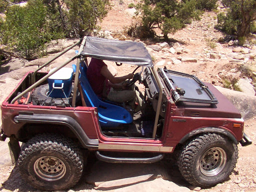

« Reply #10 on: July 01, 2011, 02:18:14 PM »
Looks good!  Here is what my SJ-410 looked like after the SPOA and 33x12.5" tires back in 2004.  :)
