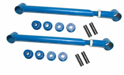

The window weld did not work.. It's definitely too soft and the inner sleeve let go as soon as i put some force to it..
I was now looking at the Calmini replacement arms
and judging by how those bushings are designed, the arm is free to rotate without any need for bushing flex.. I wonder if it is possible to convert the factory arm to something like the Calmini design..

Do Calmini do both upper & lower links?  I only see the lower ones on their site.
They state that they use reverse cut polyurethane hourglass bushings that allow more deflection and twist than the stock bushings - presumably this means that the inner surface of the bush is tapered and only makes contact with the sleeve at the outer edges.  It will allow more articulation but how well will it locate the axle in the long term?
When you ask about converting the factory link are you referring to making it adjustable or to the reverse hourglass bushings?
Theoretically making them adjustable should not be difficult - find a suitable sized turnbuckle and a machine shop that can cut both right & left hand threads and cut the link and thread it to take the turnbuckle - mind you, making them adjustable and safe is a different question, now you have to start considering the type of metal, etc.
The reverse hourglass bushings might actually be easier - a custom mould and the right shore (hardness) polyurethane - you'd have to do two piece bushings for each end because of the taper.
Why not just order a set of OEM links - try SouthWest Suzuki - compare their prices to LifeStyle Motors, they might well be cheaper.  LifeStyle has to source spares through Simpson Motors in Barbados, and for parts that are not being shipped directly from Japan, you'll end up paying duty & VAT in Barbados and then again in Trinidad - I've been able to source parts from SouthWest for less than half of what Simpsons quoted.
Just so you're aware - the Calmini links are not designed to add flex but rather adjustability - to correct a pinion angle problem created when you lift the vehicle.  As the vehicle goes up the four trailing links tip the rear axle nose upwards and the end result is that the rear drive shaft UJ angles are no longer equal and the end result is vibration - extending the lower link is the fix (or shortening the upper link, but that has less desireable side effects as the suspension moves).  My suspicion is that reverse hourglass bushing was created as a solution to the reduced flexibility of the more traditional cylindrical polyurethane bushings that I had raised earlier.
