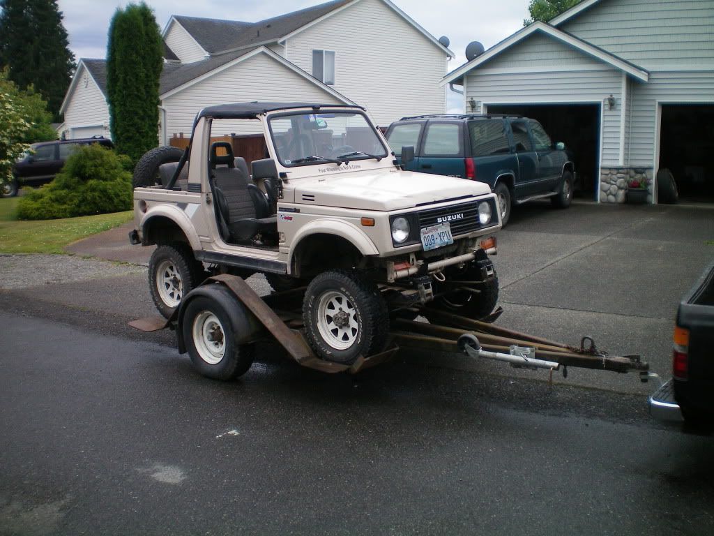

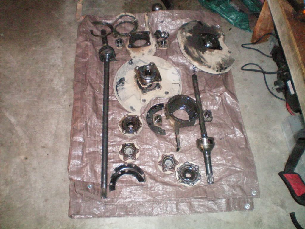

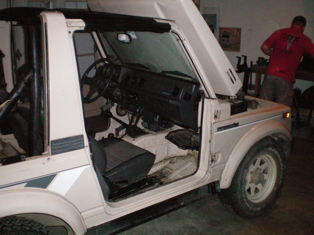

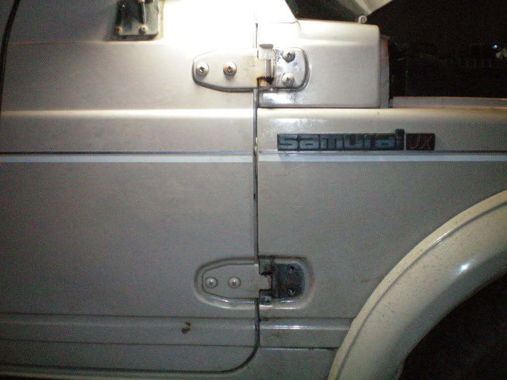

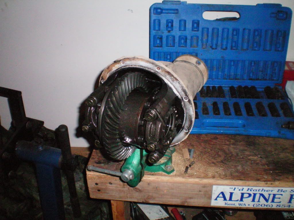

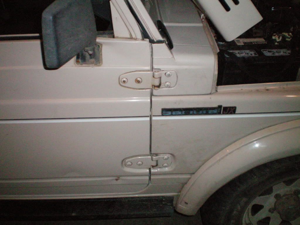

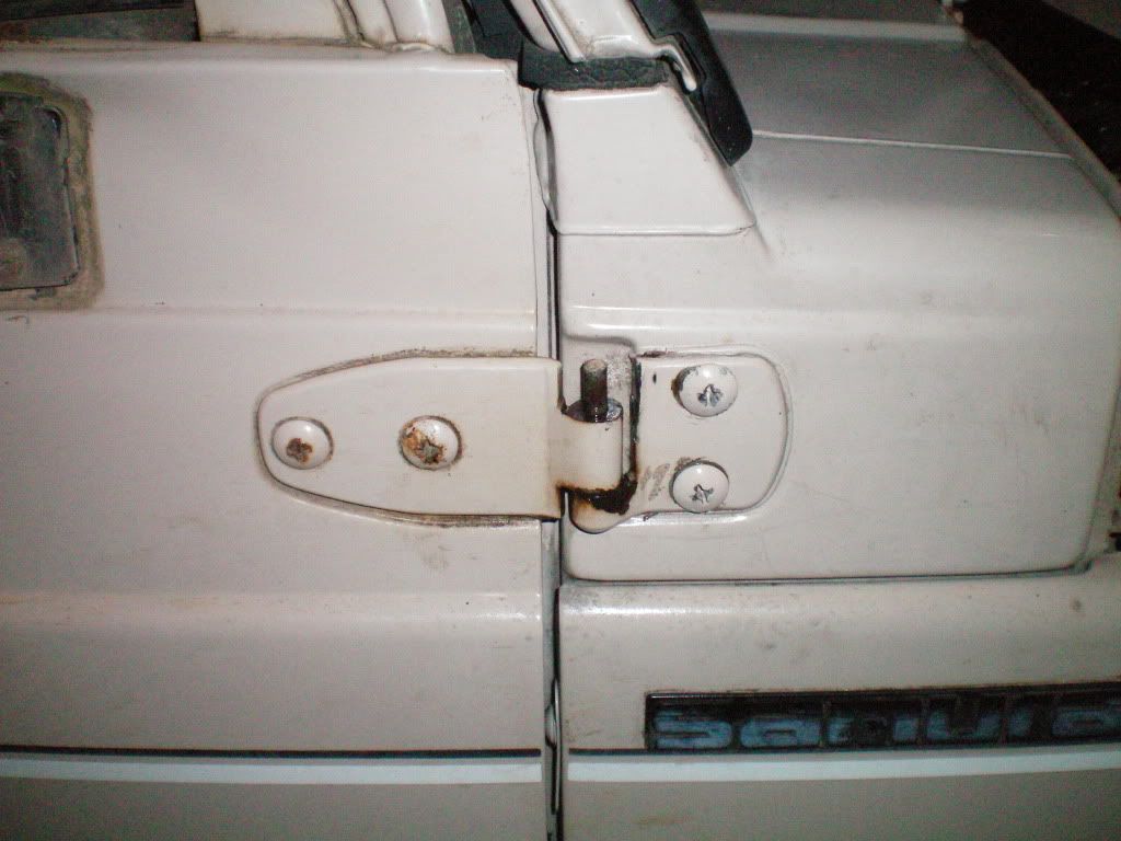

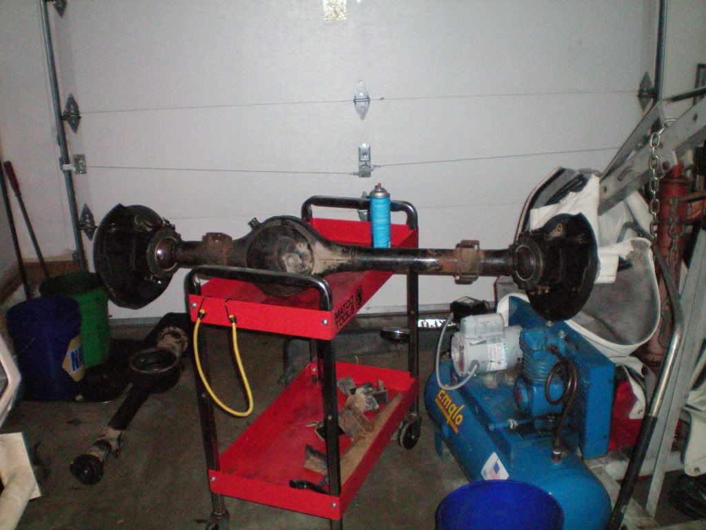

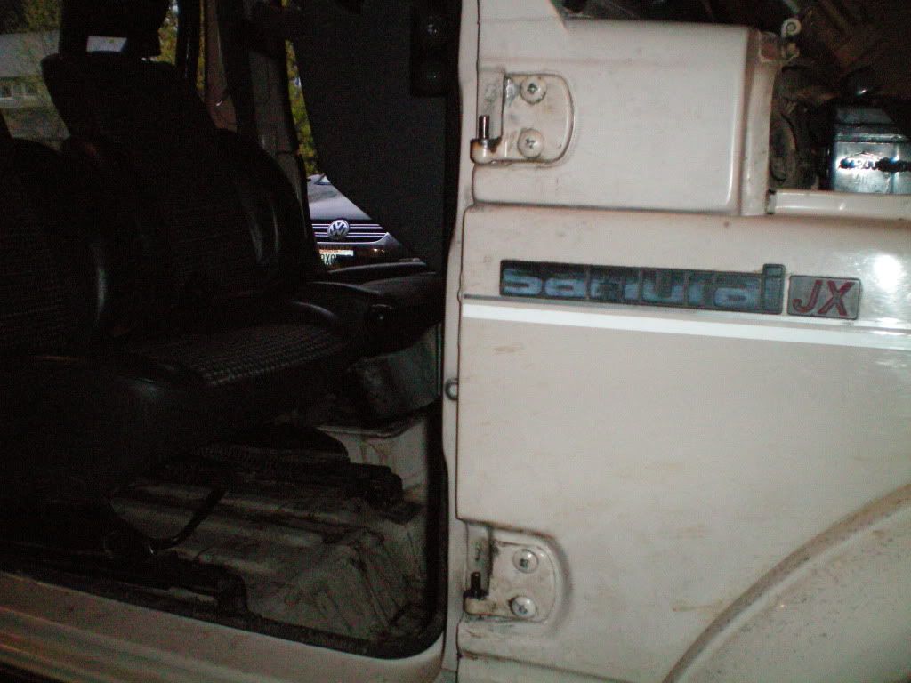

So I just purchased this 88 jx 2 weeks ago. I sold my 79 Toyota to get into something simpler and more streetable. Plans are for this summer at least. spoa with 31's. Stock gears with spool rear, maybe will get a lockright and chromo shafts installed up front. 6.5 tcase gears, full cage and fuel injection swap. So far I have got the doors modified for easy removal, got the light tabs for the windshield, relayed the starter, installed the rear spool. Also had to get a new housing since the original was bent; so i rebuilt the knuckles while I had it apart. Lift should be next. Hope you enjoy, im having a blast building/ driving this glorified side by side :laugh:

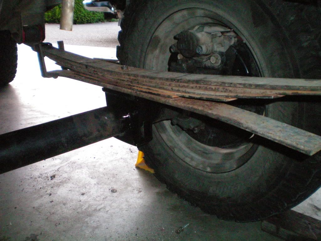

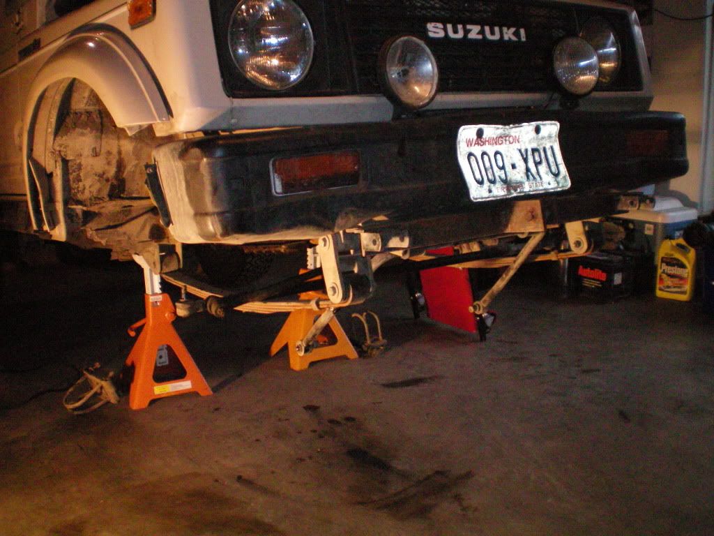

Well ordered my basic spoa from Lowrange couple weeks ago. Been slowly working on it when I get home at night. Had my friend who is a fabricator burn the spring perches on for me. He also came over and took measurements to build the shock mounts/ towers. I made a custom leaf pack up front. Using stock sami rears I took the two bottom springs off the front leaf pack and added it to the rear pack. Is definetly made a difference. I need to get another set of stock front springs to build for the back. I need to get new longer u-bolts made and order my crossover steering this week. Ill proboly order tires now to since I know 33's will fit 8) Enjoy.
when in doubt, throttle out

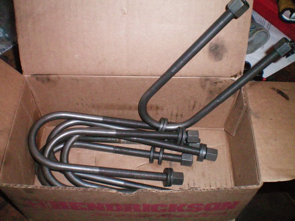

Got my new u bolts made today!. After adding extra leaves to the packs the stockers weren't gonna work. Plus its piece of mind having new bolts.Picking up my tires friday. So things are moving along. Also bit the bullet and finally bought a welder of my own! That will be here wednesday so I can build my shock towers. Ill be driving this again very shortly!

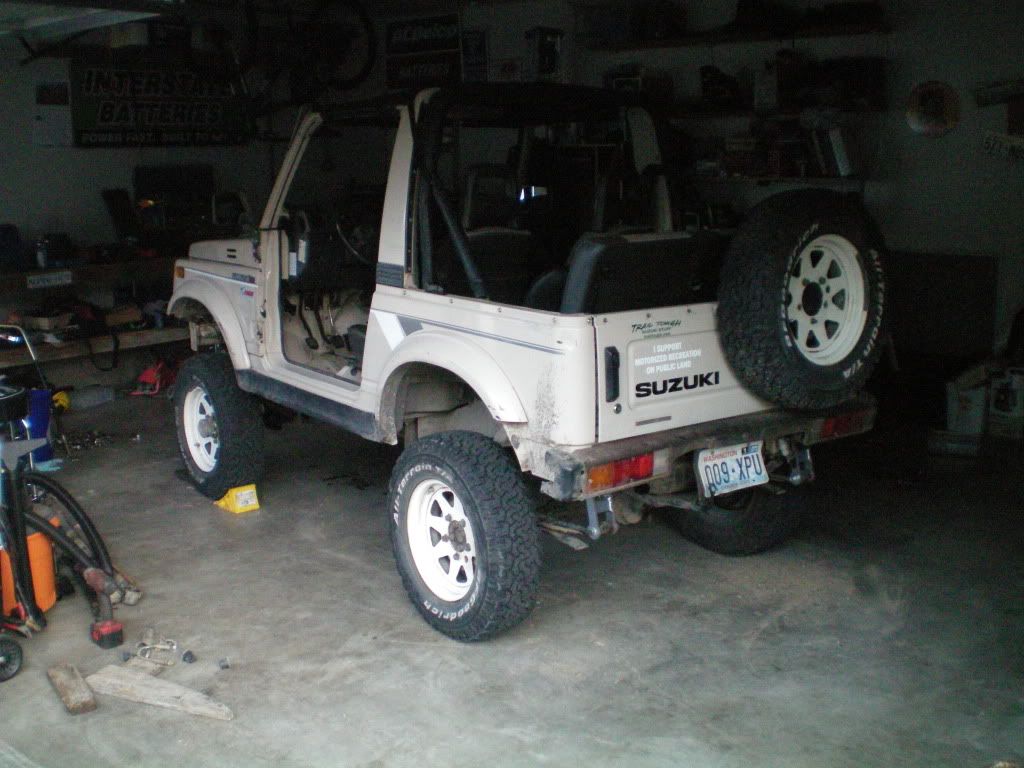

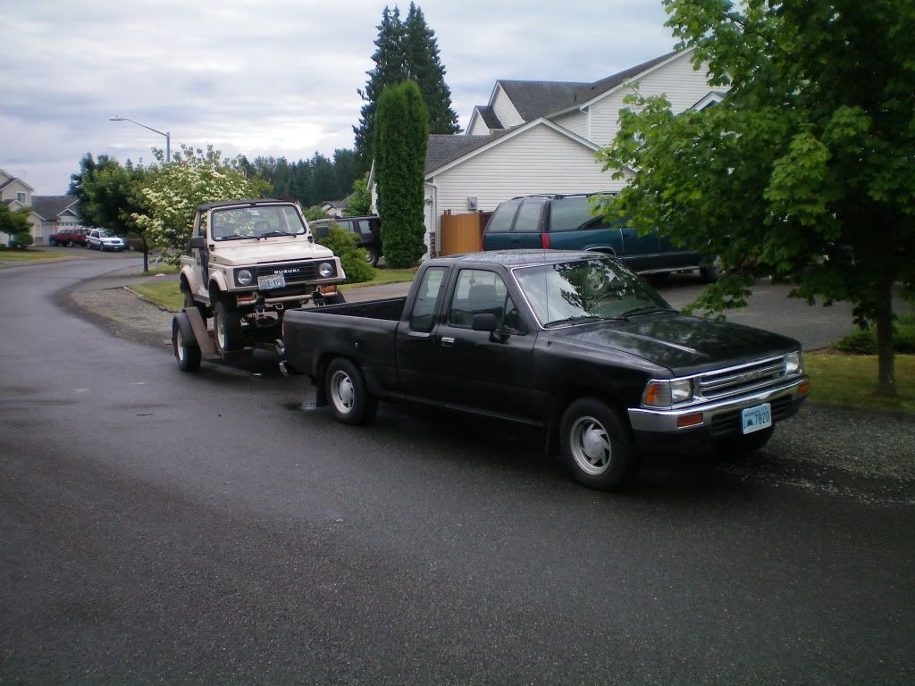

Well got a lot done this week/weekend. Got the rear packs built. Got the brakelines, driveline spacers, z-link installed. Torqued everything down, got the brakes bleed. Then got to do some driveway posing:D Got the steel Saturday to build my shock mounts so hopefully can get those knocked out this week. Getting very close to wheeling. Felt good to drive it today. Also tossed a 31" on there to check for clearance. Will need 33's:redneck:  Local built the z-link for me and the tcase bucket. They came out great. Pulled it out today and flexed it on my trailer and loaded it on the trailer to see how it fit.
