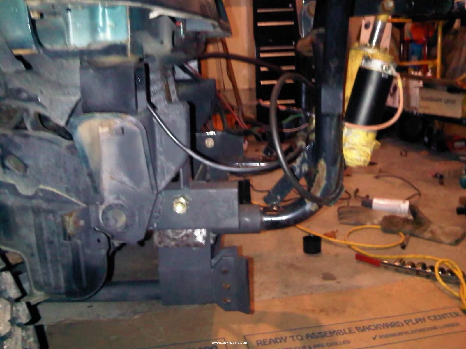

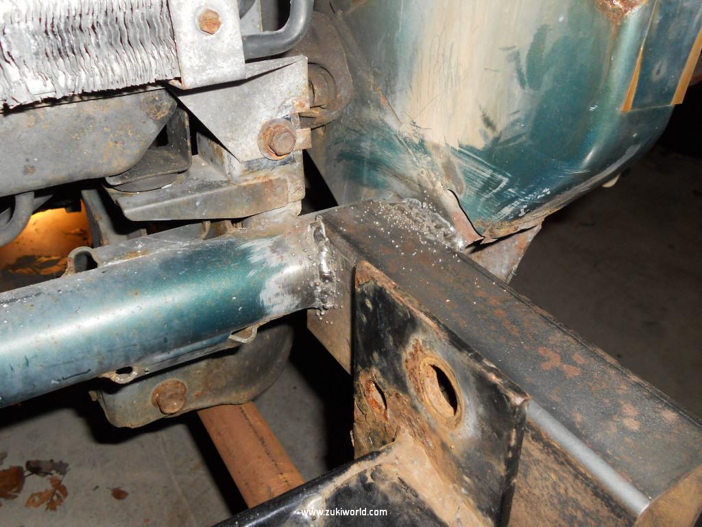

First I extended the front frame to have somewhere to bolt on the plow subframe:

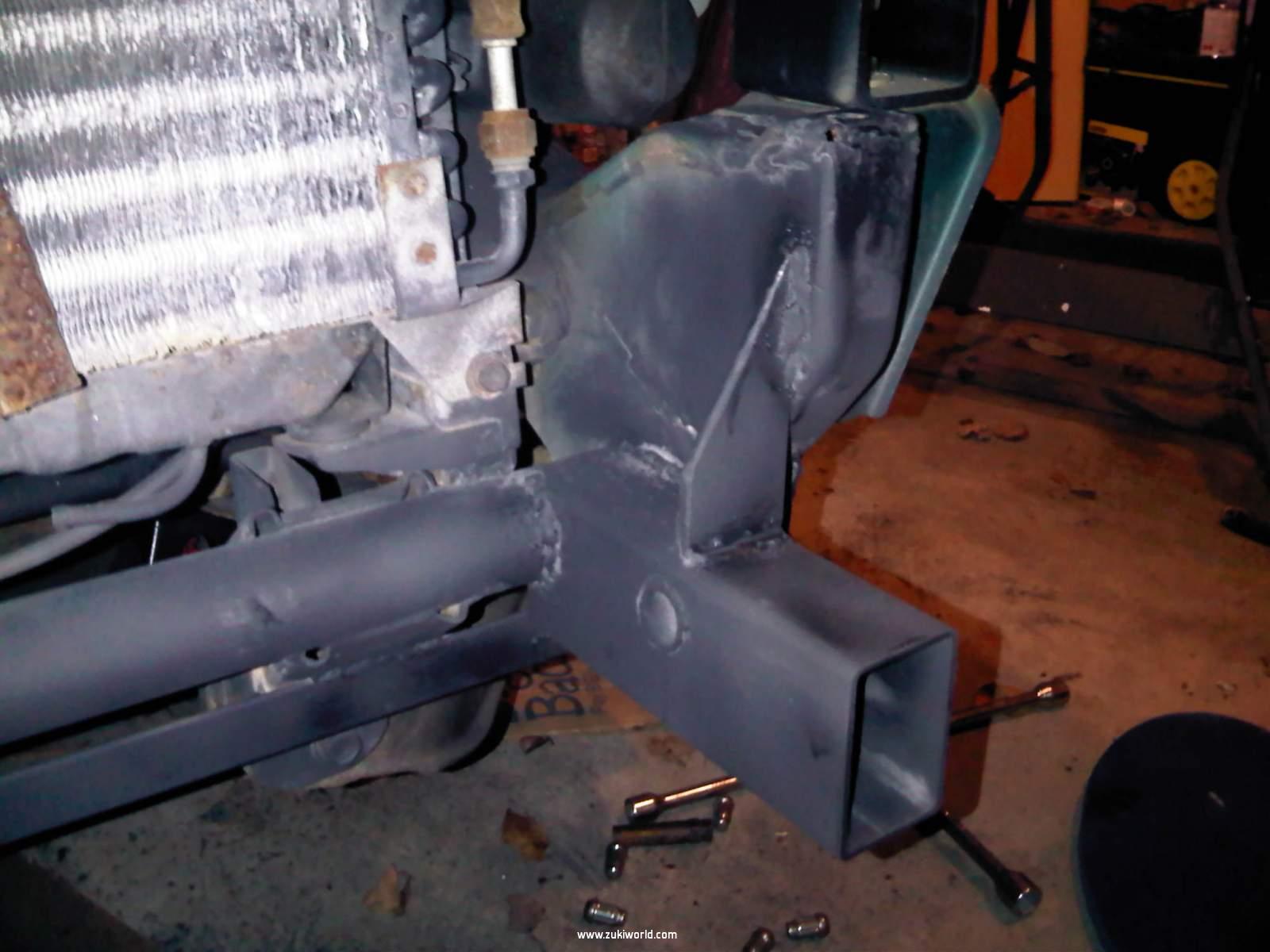

Here's a closer look at the extended front pieces.  I still need to add some bracing, but it's welded around the tube and to the side of the actual frame rail.  There shouldn't be too much front-to-rear pressure against these mounts, it's mainly to hold the weight of the plow up.  Where the plow actually mounts to the frame, there are tubes that run back to the main frame, which should take the majority of the impact.

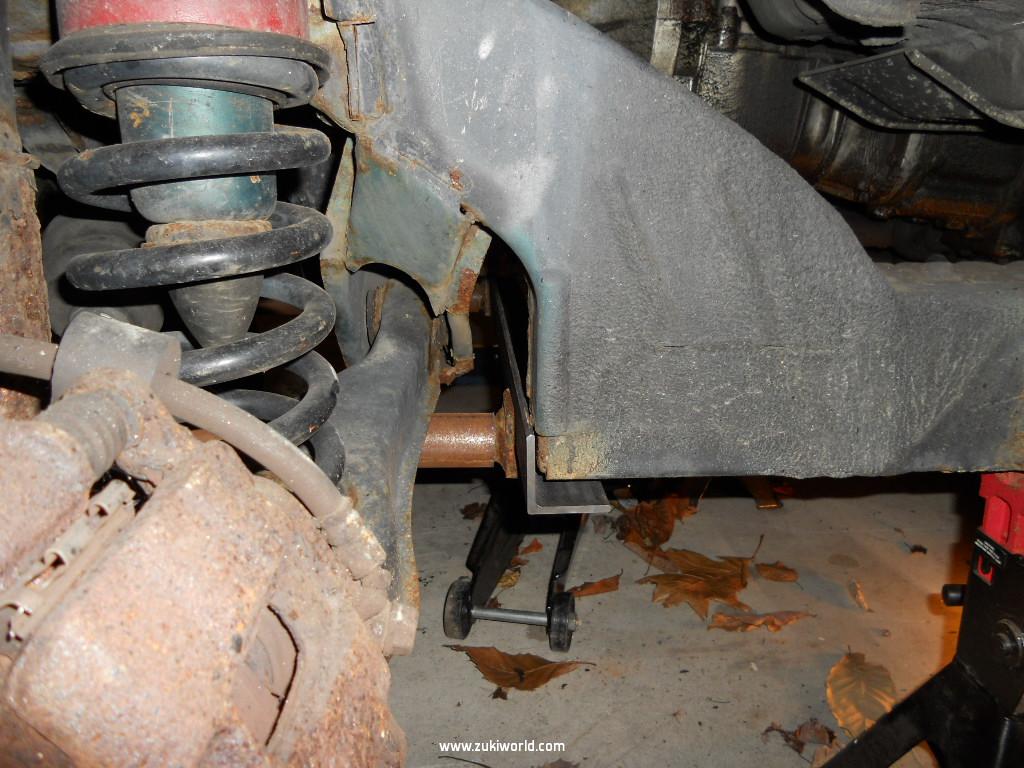

Here you can see I cut the original plow frame so I could extend the tubes to run all the way back to the main frame(past the crumple zone).  Currently in place is approximately 2.5' of black pipe. It's not the strongest, but I had it on hand so we'll see how it holds up.

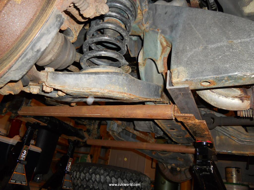

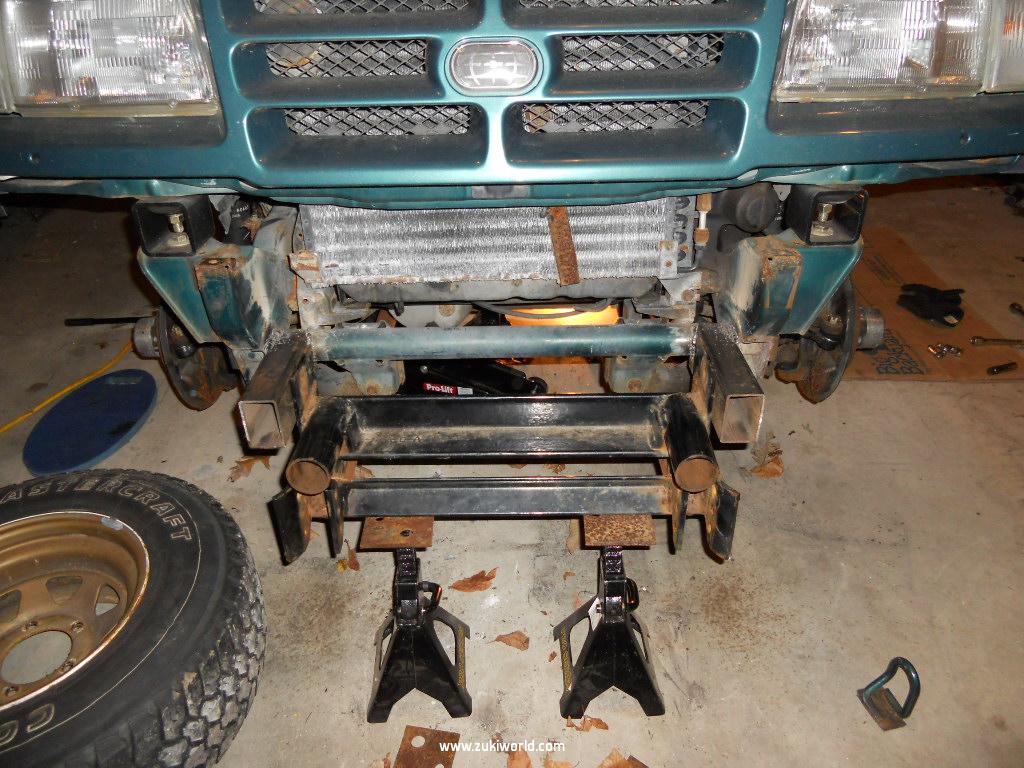

This pic shows the tubes running under the carriage, there's just enough clearance between the control arms and the tubes.

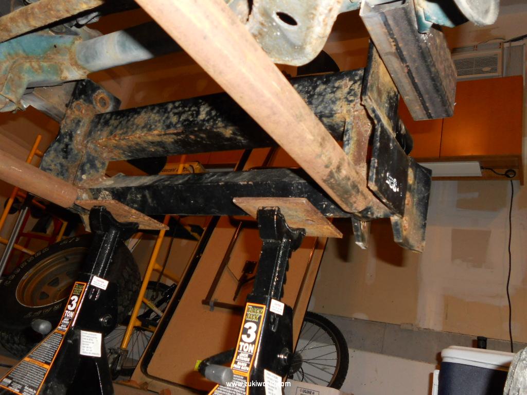

Lastly, I added a piece of angle iron to give the back section of the plow frame something to mount to.  This is actually spaced down about 1 inch.

« Reply #1 on: December 15, 2010, 07:23:53 AM »

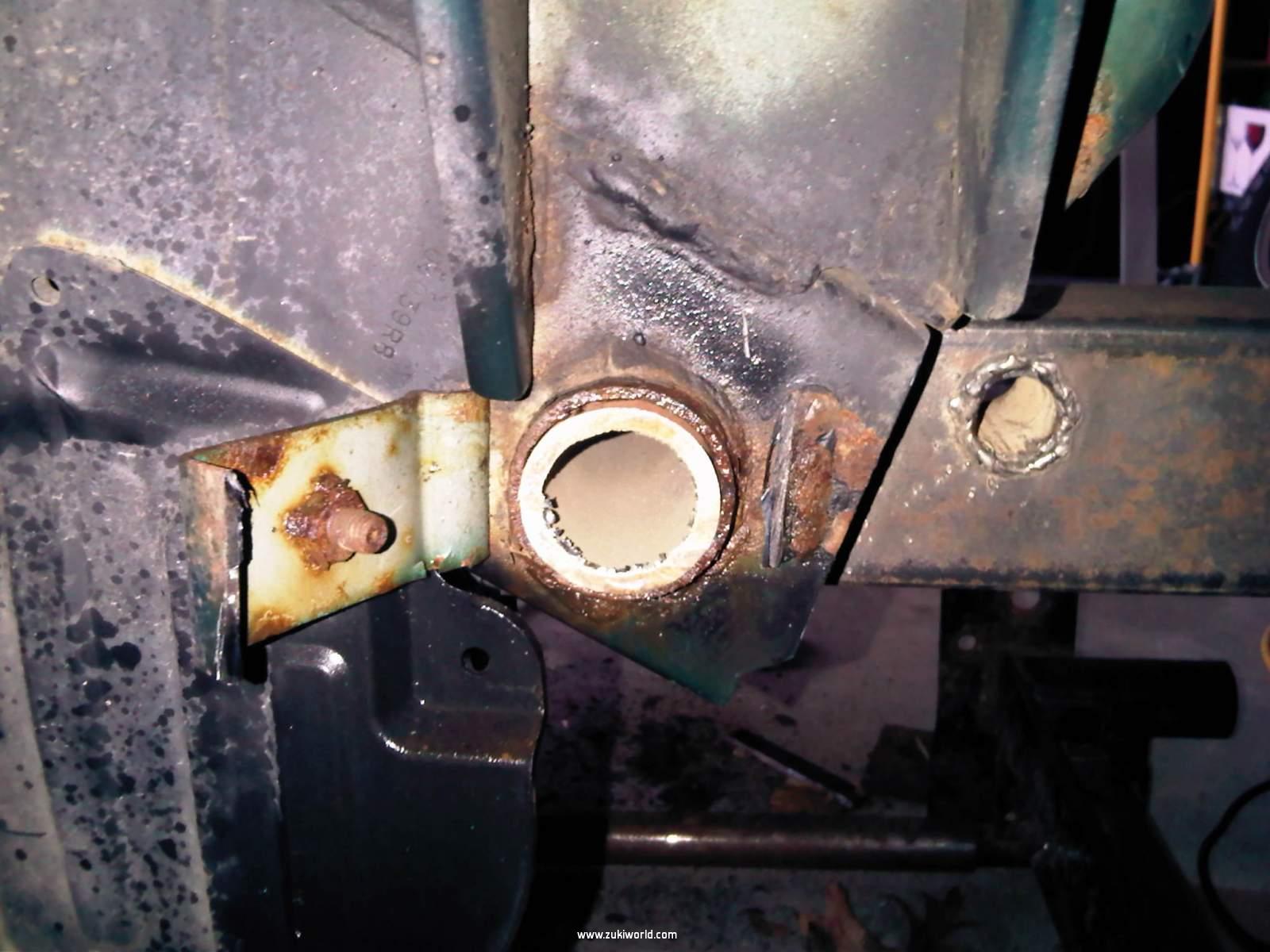

I have broken 2 frames where your front mount is welded, just from stress
of off-road pounding.
I would suggest before it breaks to pound a piece of DOM or heavy wall tubing
into the end and plug weld or weld the end into the existing frame tubing, those
stock frame parts are not that thick.
You might only get a foot or slightly more, depending on the fit of the tubing or
your sledge hammer size, if you get really lucky you might be able to get it all the way
through to the other side, in that case I would drill the stock cross member just through
to the inner tube and plug weld it.
Also in addition, weld a brace between the front a-arm mounts, this to reduce the
flexing of that upper round cross member, that should make the frame pretty bullet
proof in the front

Thanks for the input Wild.  The extensions are welded to both the cross member and the frame rails, but in general it's a weak point.  My thoughts were front mount doesn't take as much abuse, but I guess just the weight of the plow bouncing on the front while driving could be enough to do some damage.  I'll definitely reinforce the front cross member and between the a-arms.

Per Wild's advice - Dom tubing pounded into the front cross member.  I probably could have gone all the way through if I had enough material, but I only had enough to go 13" deep on each side.  I welded the ends, but still need to plug weld it.

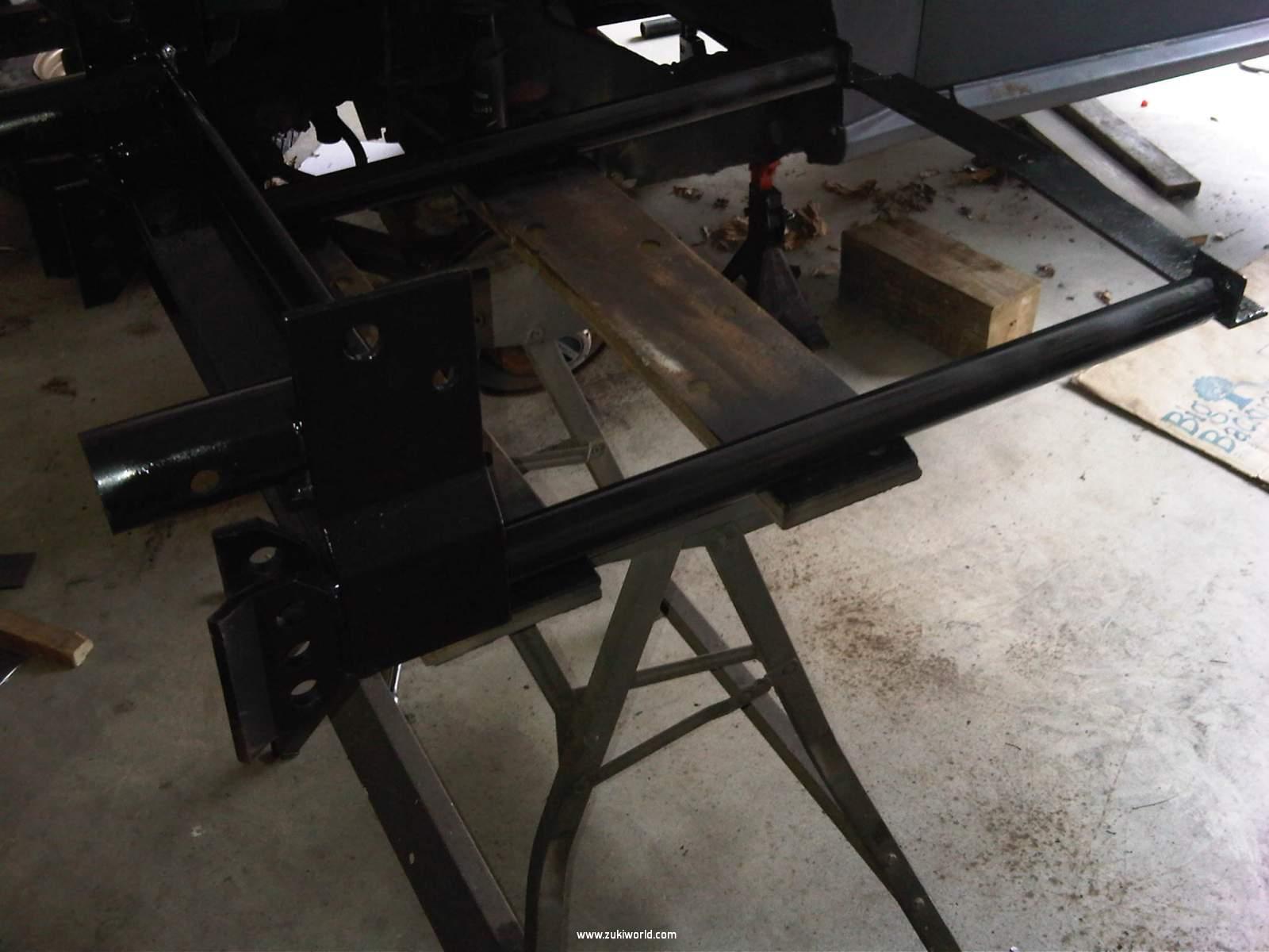

Here's a pic of the plow sub-frame extended, welded, and primed.
I still need to put a brace in between the a-arms, where do you think would be the best placement of the brace, low by the a-arm mounts, or up a little higher?

Added some bracing:
Here's the subframe all bolted up:
