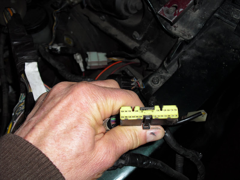

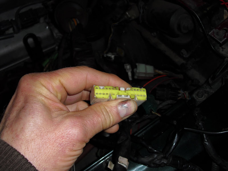

Because I put in the body lift, I needed to lengthen the steering shaft.  So I also did that and fit it in, but IT HITS THE EXHAUST MANIFOLD!  >:(  The flange on the inner side of the upper u-joint(in the left of the picture below) is the culprit.  I'm gonna try to fit a more compact u-joint in its place...
I am using the exhaust manifold out of a 2003 2.7, the CATs are smaller diameter.  I purchased another motor with a knock in bottom end, but had parts I needed.  Exhaust was smaller and gave me the extra clearance, so I figured I could sacrifice the possible hp loss.  I should have mentioned earlier, but like you focused on what I am doing to make things fit.
The two large connections that are coming off the main engine harness that goes to inside car, do they connect to go across to the combination meter?  I have been trying to find them on wiring diagram, but cannot find connectors with the pin grouping (2003 FSM).
There are a lot of wires that would go across (like in your photo).  I will be wrapping my wiring back across the engine compartment and going back in through the 93 wiring hole on left side.

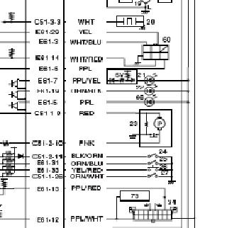

Re: Mr T - The build
« Reply #91 on: March 04, 2010, 09:40:59 AM »
Short answer: No.
They go everywhere.  To the transmission controller, to the ECM, to the Combination meter, some go to ground or to fuses, others to the BCM,  really it's a mess.  I actually don't remember exactly where they all go, but probably most of the places I've listed above.
With the 100+ hours I've spent with the schematics and wires I've gotten a little familiar with them.  Here's a collage of pics from the FSM for the 2006...They might be a little blurry, but I hope they will give you an idea of where to look.
« Reply #92 on: March 04, 2010, 06:27:14 PM »
Thanks.  I had found the C52-E59, but could not find the other plug E215-C85.  The 2003 manual stops at C72 and has E214 & E216, but not E215, so without a plug number I was lost.  My electronic FSM does not show the plugs pins, so it is impossible to follow wiring diagram.  It looks like I am going to peel back the wraps on engine harness a little ways to see where the junctions go.  Then I will now which wires need to go to ECM E61 and which will go to combination meter.  I will check on electronic FSM for the E215 to see where the wires break off to.
thanks for your time and continue having fun.  (At least you have heard yours run.)
