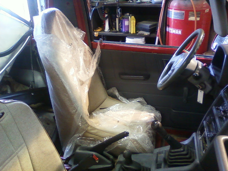

We have done a test fitting for the seats, placing it 3" above the floor looks to be just about perfect.  I hope to have a mock up of the mounting brackets finished this weekend.

Those would be the seats, the high back tan seats.  Including shipping they run at $280, sadly he was out of black but you can get gray for another $65.   They are pretty comfortable at 6'4 and fit just perfect in Tracker.  I don't think there is enough room for the wide version of the seats but I could be wrong.

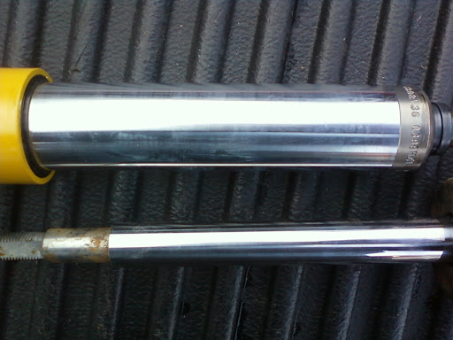

For those of you interested in the difference between a stock OEM strut and the Bilstein:
Which do you think will hold up better in the long run?  :D

WOW that is a big difference. my only question is it a solid shaft or hollow? It look way over kill compared to the oem strut. just wondering how much do those struts cost compared to the cheap ones?

also, is there any difference in travel?

Travel is the same and they are quite a bit more expensive then a cheap replacement at $275 for the pair including shipping from Tirerack.com.  But I have had a cheap strut blow out after one trip, so it's a trade off.  The part number is F4-V36-0399-H0, you can find them cheaper sometimes on-line if you search around.

hey can you show how you set up your seats. i just picked up some with 5 point harnesses at last weeks swap meet.  i also was planning on putting the front seats in the back, has anyone done this.???

For the seats we are building new mounts but they are going to be bolted down and not have a slide rail.  We should have them mounted next weekend.
After putting seats on my SJ-410 I decided the easiest thing to do when putting in 'racing' style seats is to just unbolt your existing seats and weld an adapter onto your existing frame.  That way you keep the stock slide and it fits your rig properly.  They had a great deal on seats down at the swap meet but by the time I got there they only had drivers side ones left.
