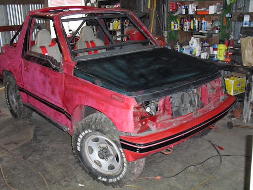

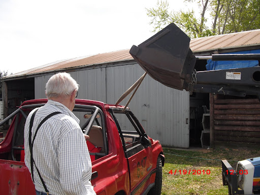

Time for the heavy equipment.
Seems to have worked, we can now use both doors.  Tomorrow I will try to fit the hood off the Brd Hntr, seeing as it will not fit properly with the envisioned motor change.  Then the Project Trouble will look like the Drones ear probably does Dark Blue, Green, Red, & Black.

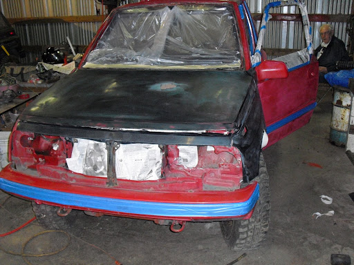

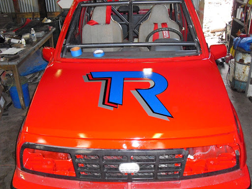

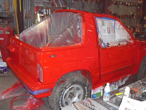

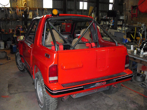

Another round up updates from the dedicated half of the team, the guys from up north.
Monday - Straighten body, fit fenders, adjust door:
Tuesday - fit hood, mask & cover, paint:
Wednesday - repaint hood, remove masking, put lights and trim on, put decals on:
It's a wonder I head up north at all.  They seem to get all the work done when I'm not around.  As always, full size and additional pics available at http://picasaweb.google.com/CrawlersNW/RaceCar

The project is looking better and better....even after a rollover. I really like the hood logo, nicely done.

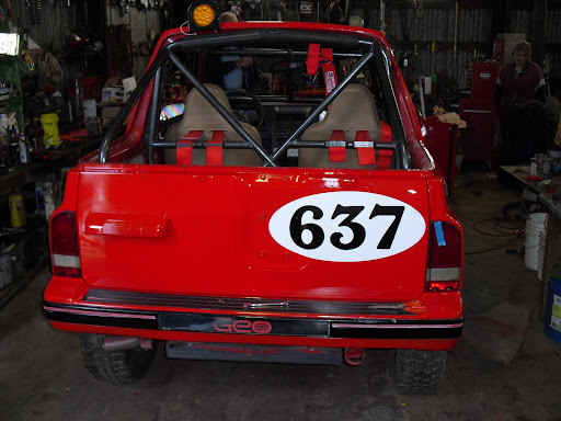

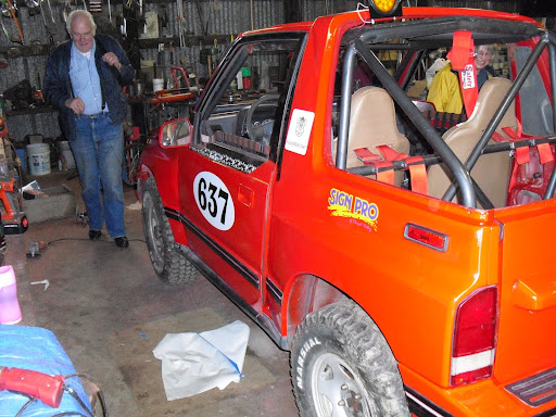

Hey Drone, as I read the rules you have to put the number on plates in a certain place. Just a FYI for ya.
"Numbers must have one inch of space between them.
Numbers must be a minimum height of eight inches and be a minimum of one and
one half inches wide.
Minimum number plate size is ten inches high by fourteen inches long.
Numbers must be located in the following positions: On the rear of race vehicle, high
and close to the back of the cab and on both sides of the vehicle.

As I read it you had to have numbers that are 8 inches high and a minimum of 1.5 inches wide with and least 1" between the numbers, one on each side and one on the rear of race vehicle high and close to the back of the cab.  We put it on the tailgate as we are actually running one without a spare tire on it.
The rules don't say anything about where to place the number on the side of the vehicle.  Just that you have to have one that is easily visible and identifiable by the scoring table.

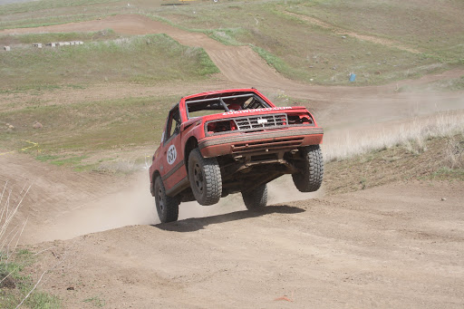

Before the race I put on a set of 'high end' Gabriel shocks from Autozone.  They seemed to hold up, could have used a bit more travel and cushioning when coming off of a jump or hitting bumps at high speed after going down a dip.  Still, they worked well enough.
Successful race.  During pre-running we almost overheated as the electric fan stopped working but BRD HNTR noticed it in time.  Ends up there was a dent from when the vehicle was rolled that was catching the fan blade.  Some time with pliers and a mallet fixed that.  We also broke one mirror off and the air horn filled up with dirt and stopped working by the time I actually had a reason to use it.
The front wheels look to have the same alignment as when we started, so the bracing worked and the front struts stayed working without issues all day.
Some teaser photo's from the race.  More pictures and video to come as time moves forward.
