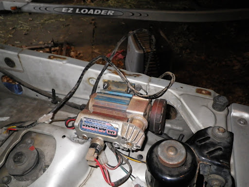

ARB switches where installed to the left of the steering wheel, the switch locations easily cut out with a box cutter.  However, I carefully trimmed the boxes to be perfectly square and match the moldings only to find out the switches are just a touch smaller then the moldings in the dash.  So they wiggle just a touch, that will be resolved with double sided tape.  I also had to trim the top of the ARB switch just a touch to stop it from rubbing on the top edge of the dash. If doing it over again I would make the box a bit smaller and make it as low as possible in the dash.
The Mini-ARB Compressor is mounted in front of the air filter in the front end.  With the fender off I actually mounted it sideways to avoid drilling into the fender well, mounting it off the side instead.  I had to dent the corner of the strut mount cover for clearance but everything fits.  Waiting to run the ARB hose until the diff is mounted.

Its looking good ! Can you put up some more pictures of the ARB compressor install ?
The 33's look real chubby without a lift.
Thanks, it will be interesting to see how she looks when finished.  Provided we get to that point. :D
You can see the dent I put into the strut mount cover for clearance:
The mounting from the back side:

Nice update, and thanks for posting the compressor pictures. Its good to know that if you really want to, you can make the Samurai ARB fit in the front of a sidekick.
