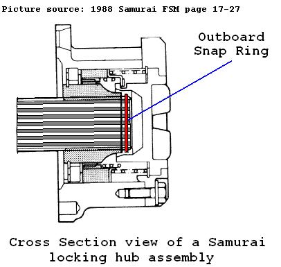

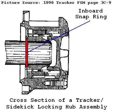

There is one main mechanical difference between the Samurai manual locking hub and the Tracker/Sidekick manual locking hub that has a direct effect on the swap.  It involves the snap ring that holds the outer end of the axle shaft in place on both models.
The snap ring is outboard on the Samurai.
The snap ring is inboard on the Tracker/Sidekick
The snap ring really cannot be left out when you install a Samurai locking hub on a Tracker/Sidekick. The snap ring holds the axle shaft in place so that the CV joint (or Birfield joint in the case of the Samurai) always remains in the center of the axis of steering rotation.  It also keeps the seal closed on the back of the Tracker/Sidekick hub assembly

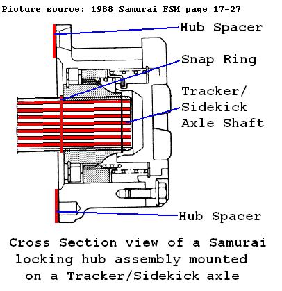

If you buy a Samurai locking hub and install it on your Tracker or Sidekick, you may  find a narrow gap between the base of the locking hub and the hub itself.
Yes, I said "may". More on that later.
This occurs because there is no room at the base of the Samurai locking hub for the Tracker/Sidekick's inboard snap ring.  The solution is to somehow make space for the snap ring:
A popular and inexpensive solution is to make a spacer ring. Note the hub spacer in the above picture.  It is actually a metal ring that is the same thickness as the snap ring. It basically looks like a metal version of the gasket that sits in the same location.  At this time, this spacer is something that you have to make yourself.

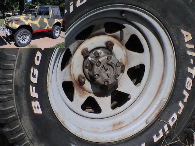

Actual, real Samurai locking hubs

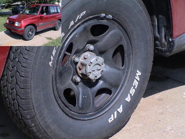

Actual real Samurai locking hubs on a Suzuki Sidekick.

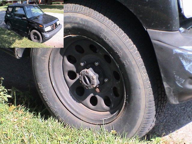

Tracker (Sidekick) locking hubs on a Tracker.
