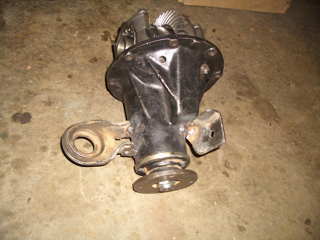

3) Fab up some brackets. Mount the nugget in the banjo and bolt it in to your rig. Now tack the brackets in, then remove once aligned and weld them up.( Check out the pics for brackets ).

Hi j2 - yeah just make up a couple of small caps that fit inside the holes, "V" the edges and weld them in , that way they will end up flush mounted.
BTW: The reason we have put two brackets on is to stop the rocking effect that seems to be the culprit for cracking the front banjo - this set up is very strong and distributes the stress amongst ALL the mounts increasing reliablity - running this with a steel GV banjo would be the ultimate as far as Kick IFS is concerned.

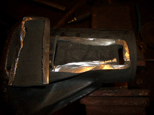

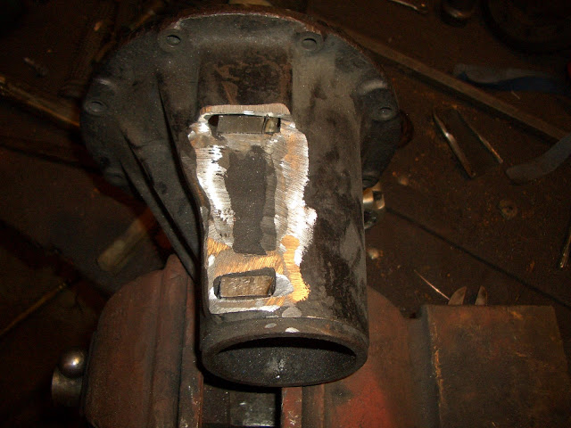

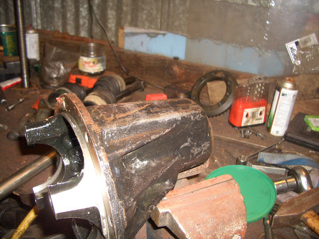

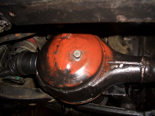

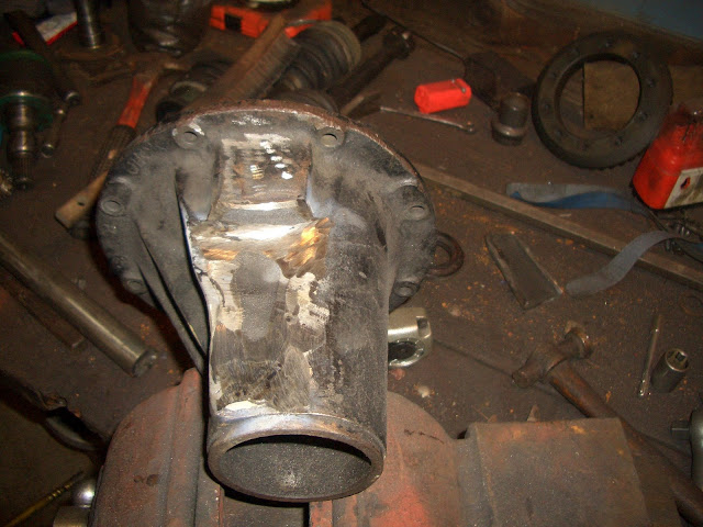

Thanks for the good write up.  I was going to do this mod. for my modified samurai rear/tracker ifs, hoping it did not get too involved.  Drone637 foreworded this to me to show what/how it needed to be done.  As this still left some guess work as to cutting, I have included more photos as my work progressed.  I used a 1/16" cut off wheel and a grinding wheel in a 4 1/2" grinder.
Third member before I started
Cut lines I used
Cut section removed
Plugs ready to weld
Welded and cleaned up ready for paint
I am using the tracker rear diff mount, and another diff mount bushing that uses Whitfields idea of using the rear A arm bolt instead of welding it to the cross member.
Diff can now set at least 1" lower without hitting cross member.
