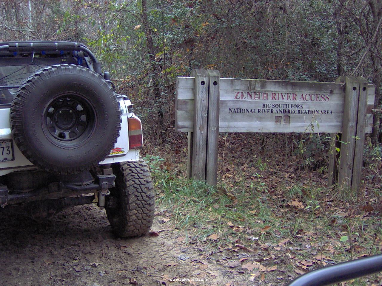

I also was wondering about the tire size... With the 5.71's I'm guessing 33-35's... Did you mock up a full size spare before mounting the CB antenna? A 33 takes up alot of room.  :-\
a 33" spare on my 2 door

ya it was spintech, it sounds so burly for a 4cyl. beleive or not people always ask if i swaped the motor, lol
i have 4 stock leafs from both years. i will run those and thirty three inch swampers.  I have heard from some of my buddys the toyota leafs will flex great with my little rig.
i didnt mock it, but i am going to cut a square center section from the sidekicks stock tire mount then re-weld in a stronger peice with toyota lug specs in its place.

hey went out and measured the distance to the CB, i got 18" to the antenna. HAHA 36" tires lol hells ya
Good deal.. close fit there  8)
