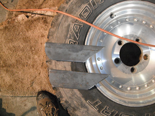

So I had generic copies made out of 3/16 plate.  (The greasy ones go on the Drone's DD.)

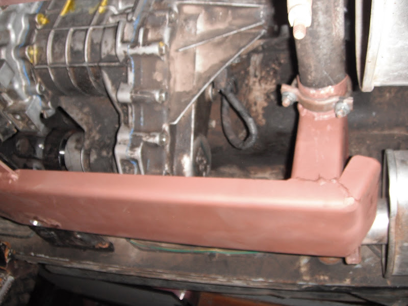

My transfer case output section hangs a little lower than the rest, so I welded the pieces together and create the lower protection for output shaft.  You can see the back mount I made to fasten to the crossbrace I had raised.
I primered it, made mounts for the front, drilled holes in lowered section to hide the bolt head and bolted it in place.
Still have to make the front section, but this is a good start.

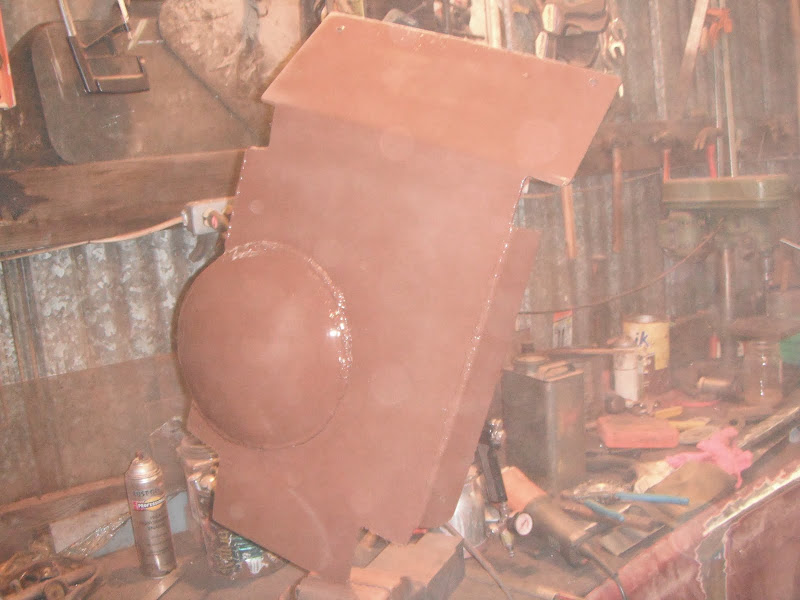

Back to the skid pan.  I went down to metal shop and bought a 16x32x3/16" remnant, figured out where a how much I wanted the bends to be, and had a friend bend it.  Then I cut out where the lowered diff would go through the skid pan,
I used the bottom of an old cylinder I was going to throw out to cover the hole.  After welding on wings as stiffeners it is getting closer to what I envisioned.
I had to cut off the section I was going to attach to the bumper, and use tabs instead.  Now mounted under the Tracker.
That is my new Skid Pan.  Last section was $25 and IOU.

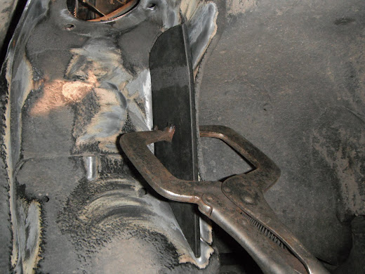

Installed strut stiffeners like on Trouble Race Car.  Only took a couple hours.  I used 1/4X2" flat bar stock, and cut them to fit.
I had to bang a slight bend into them to make a better fit.  Fitting them in place.
Welding completed.  They are welded on both sides of the flat stock.
As the Race Car struts seemed to stay in place, These should keep my struts from flexing.

Bracing along the inside like this ties the upper half of the strut tower to the bottom half where it is attached directly to the frame.  In order for the top half of the tower to bend it would need to pull the welds off of the frame.  You could add more to the end if you wanted, but we didn't have any issues with the strut towers bending on Project Trouble.
What I really wanted to do was cut 2" out of the middle of the strut tower.  If you reduce the height, you reduce the leverage.  I am running 1 1/2" spacers that could be removed, and reduce the leverage.  I just didn't have time to do it before MOAB, so probably won't get done.
Drone's Race Car was thrashed pretty hard without signs of the strut towers moving, and I know that my Tracker won't be driven that hard.  If this doesn't work, then back to plan A.
