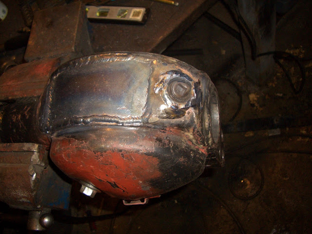

Finished the oil passage modification.  I use a write-up by ZuesZuki http://www.zukiworld.com/forum/index.php?topic=21156.0  and added my photos to his good thread.
Finished modified third member w/o lower oil passage.
The samurai housing has a much larger banjo then the aluminum, causing it to hang below the (already lowered) cross member.  So I removed the lower portion of the housing and welded in a patch even with the gear mount (very similar to the aluminum).
Cutting out the bulge
Patch replaced and oil drain moved

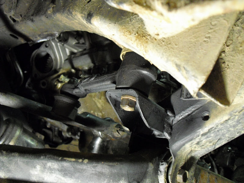

I then changed the mount to use third member bolts and original cushioned mount bracket.
And now have it installed
It is setting a little low, the shield on drive flange hits cross member on bumps, so will have to raise mounts 1/2" or so.  I have made some road trips with it, and drove around the field climbing over logs, and testing the ARB.  I am test running w/o the front sway bar hooked up to see how much effect it has on normal road driving.  I know that I am getting a lot more flexing and use of the  ifs w/o it.

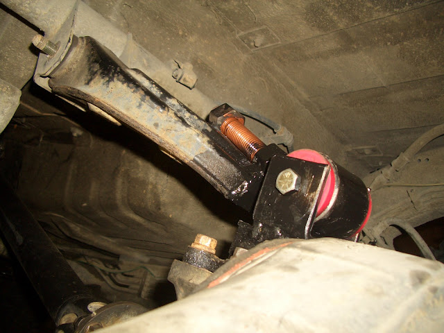

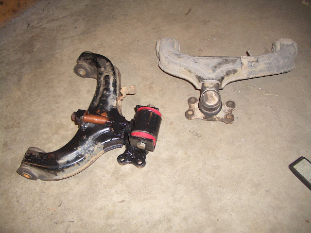

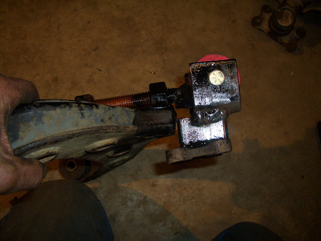

With the lift I have, I have been concerned about the upper mount on rear end, so I made a new mount for it.
First I cut off the ball joint, then used the eye off an old spring and welded a 3/4" stud bolt to it.  I put two nuts on the stud bolt and positioned it on top of the upper arm and welded the nuts in place. (I spread the nuts apart to make it stronger, as I welded one side of the nut to the upper mount.)   I used a piece of 2" square tubing to raise two side mounts for the spring ends and welded them to the upper diff mounting bracket.  Then I put new poly bushings into the spring and bolted it in place.
This is a comparison of the two mounts.
Side view
And this is with it hanging.
(I ground off some of the front of square tubing for clearance, and put the missing nuts and washers back on.)
I do not have to worry about this breaking, and should have a little better flex.

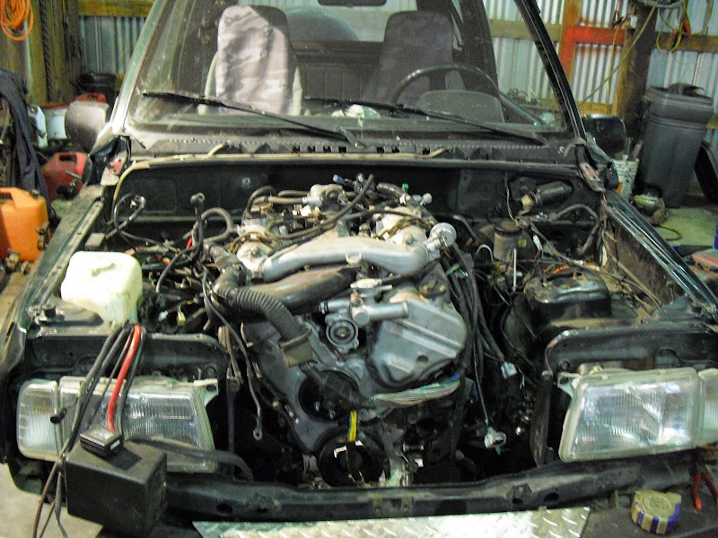

Finally found some time to work on the Tracker

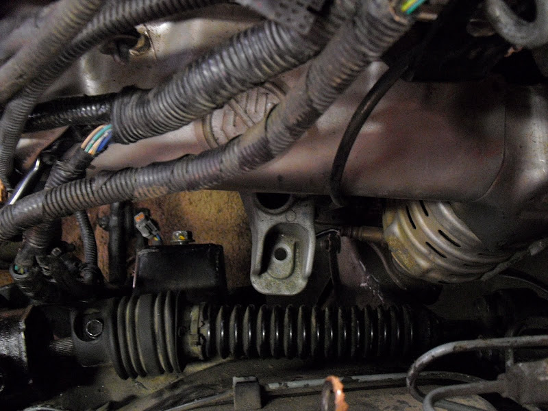

I removed the motor mounts from the frame, and then moved the brake junction connection from the frame up to the fender well.  I modified the Pitman arm and idler so that I had 1.5 inches of drop (with the motor setting in it steering linkages are almost straight across). I built a brace to go on the bottom of the idler and welded it to the A arm support.
Then I tucked the motor and transmission back in it.  I put a piece of 1" square tubing between the pan and tie rod and set the motor on it.  Still have to center and change exhaust manifolds.
I now have the transfer case mount bolted in place, and I can check and see where the new motor mounts are going to be.
Correction, when I moved the motor to center it, pan was hitting back crossmember.  Tried changing to one of my other Transfer Case mounts, they would not fit.  Tried changing out different TC mount which moved it the wrong way.  Then double checking the XL7 TC mount it is offset about 1/2 inch, and I had it setting with the offset to the back.  Turned it around and pan is now clearing by 1/4" - 1/2".  I may ding that corner in a little (as I slip it back in) to ensure no possible rubbing.
I switched exhaust manifolds to 2003 as my 2005 were bent so they would be hitting crossmember, also pre-cats are a little smaller.  Exhaust on the passenger side is tight, so will probably install a small heat shield (pre-cat already has one on it) just to keep brake and fuel lines protected.
