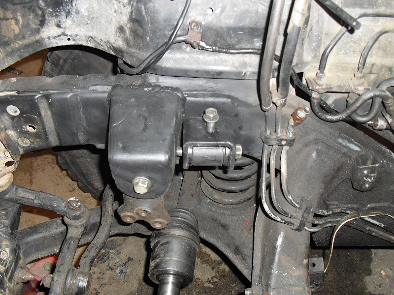

I worked on the Tracker all day, but gains were slow.  I raised the motor and put the front diff back in, without the two mounts (using jack for now).  Lowered the motor back in place, at least as low as it would go.  Welded the bottom side of motor mounts in place.  I will weld the top side when I pull the motor (hopefully) one last time.  Not much clearance between pan, crossmember, and diff.  I will definitely have to do some hood work.  If body was off, I would have done a body lift, or frame chop & drop, body is not off so hood work it will be.  Have my old alternator ready for adaption to its new spot, will be able to use the 2.7 mounts, and drill out my alternator holes, or sleeve the 2.7's holes.  I tried to use 2.7 mounts for my PS pump, but could not make it fit, so will be modifying my old mount some more.  There is room for my pump where the AC pump would sit.

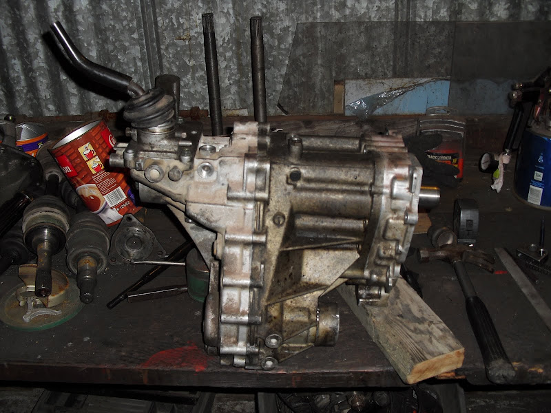

I have converted the electric shift transfer case to a manual shift.  I ended up using the center of the 93 tc (dropped the 2005 electric shift tc and cracked the forward drive housing), and installing the heavier gears in it, then using the larger tail shaft, and heavier input.
I had to change out the two shift rods, so the manual shift had proper contacts for shift lever.
Now it looks like this.

I moved the right frame diff mount back about 1 1/2 inches for clearance by the alternator, also modified the mounts on my diff so I can use stock hangers on both sides.  I may build steel hangers later, but thought the stock ones were stronger than my modified ones.
New motor mount, and moved brake line.

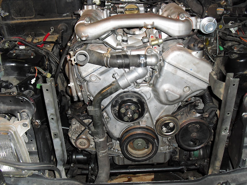

I have alternator mounts, and alternator in place.  Took two trips to NAPA to get correct size belt.  Power steering is in place,  two trips for ps belt were not enough.  As I am going to start using my old radiator to see if it will work, I had to modify the outlet lines to put hoses in right place.  I added a 1/4" spacer between the outlet line and block to create clearance for bolt holding inlet line in place.  I was then able to turn the outlet over so it would exit to passenger side, where radiator inlet line is.  I cut off the wrap around line, so I could use old radiator outlet hose.  Then I ran a brace from radiator outlet line (that I cut off) to a hole on alternator bracked.
There is more clearance for alternator than it looks, bad angle.
Power Steering is close, may have to bend outlet line a little more for clearance.
My plan is to route engine wiring behind intake and into same hole the 93 uses for engine wiring.
