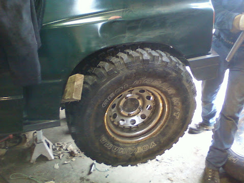

As it was jacked up we had to see how it would look with 33X11.5's  (suspension fully stuffed.
My 30X9.5's

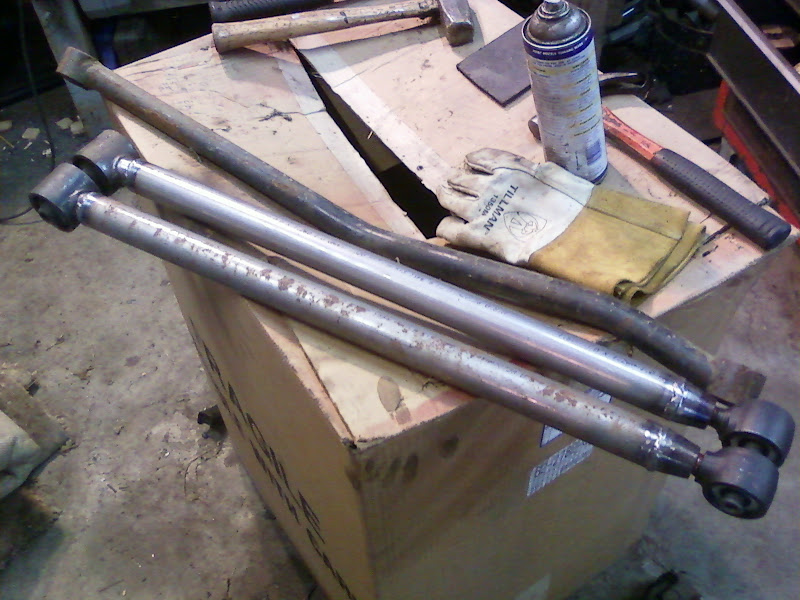

Start with lower linkage (forget it was still in place).

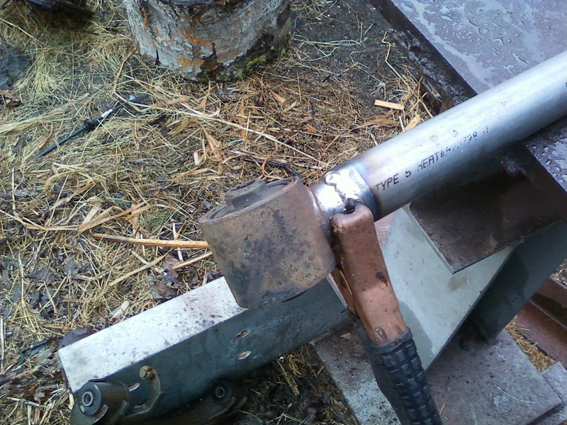

I am using stock rear mounts and linkage ends.  Just a little grinding and it will slide into 1 1/2" DOM tubing.
Then use welded bungs with Johnny Joints for front end of linkage.
When suspension is completed I will get the drive line cut to fit.

Almost finished with them.  They do look nice.  I was hoping to leave the bottom axle mounts, but will have to move them up to get good numbers.  I tacked all the mounts and measured to make sure of height on all mounts, and must have missed something.  The upper frame mounts are 1/4 inch lower than planned, which really throws the numbers off.  Easiest way to correct it now is new lower axle mounts.  I didn't like them sticking down there anyway!!!!
