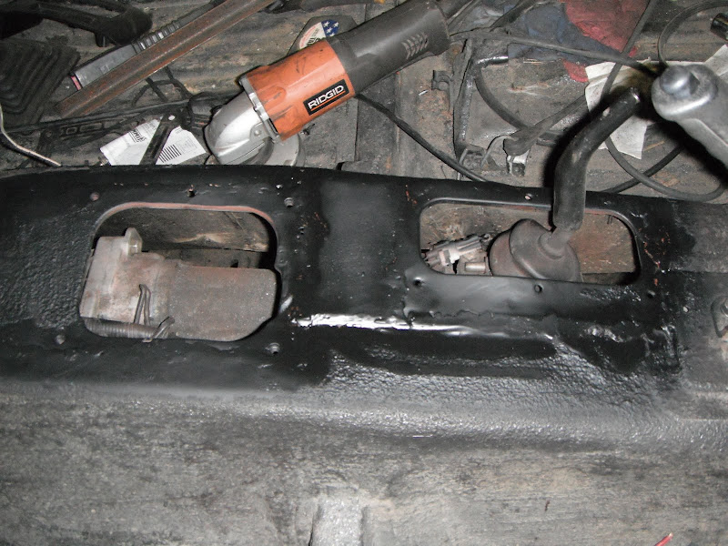

I moved floor hole for the transfer case shift linkage back so it was cenetered, then I moved the transmission hole back same distance (would have been much easier to move whole consul section at once).  Now the shift cable won't be so jammed up and shift linkage will have space before the dash.  This took all after noon.

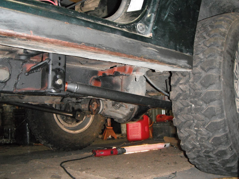

New drive line is installed.  Cut shorter than I would like, but plenty of room left for flexing.  Working on exhaust now, one side is blowing on the fuel lines, so don't want to run too long that way.  Still have some wiring to finish up.  Tried my silicone connector idea last night, have to go see how solid it is now.
