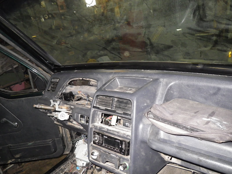

Just set the dash in, and couldn't have been much better fit.  There is room in front of brace across top of dash for defrost to work and to clean whole windshield.
Now to hook everything up.
