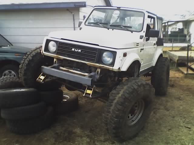

Here ya go  My buddy did a ton of. the work for me he builds monster trucks for a living pretty much. .  I have a toy 20r punched 20 over with an offenhauser manifold a weber a downey no gasket header recurved the dist.A downey cam heavy duty valve springs all toy axles 4:88 gears lincoln locked v6 rearend limited slip frontend toy transfer case. Sky hi steer, warn m5000 winch dual batteries with isolator, toy radiator, fleax a lite electric fan. I have toy ifs power steering unit sitting in the garage ready to go. 39.5 swampers and painted ford racing orange to make it stand out just a little because thats my sons favorite color. I think I blew the rearend out of it. Does anyone no the # for genuine gear oh well it's only money, right.  Centerforce dual friction clutch. Balanced drive shafts

It looks like your bumper weighs more then the Samurai.  ;D
Nice looking build though, very clean.  :)

are the toy axles stock? how did ya upgrade the birfs?
curious how many shafts ya brake with 39.5's, you must break plenty int eh mud.

Even if thats a Toy axle its still way maxed out on tire size.  So i praying that there are some longfeilds in there. hahha
Other than that it looks pretty dam clean, possibly to clean to be a trail rig.
has this been on trail? or just alley ways?

What do you want me to say, that I break axles left and right. and that it never sees the mud it simply isn't the case at all. I ran 36s with sammi axles and then 38s for awhile but then I broke two axles I think and then I put toy axles on it. You can ask anyone from Kissimmee Orlando Mascotte area that has seen me run the truck I'm not easy on it. Sure I get stuck but if you don't get stuck your not running your truck, everyone gets stuck at some point. Do I go in the holes that the military (2.5ton)guys go in yea and I get stuck so what it's about having fun isn't it. It is common place to see toy's run even 44s and yea they break but it's not the burfield it's the axle a $100.00 and it's fixed most the time sometimes more Like my rearend so I'll fix it and run it  some more. I have some old pics when it was white. I'm not able to upload the file because it is too big.  I just painted it maybe two months ago is why it looks so clean.  I'm really want to go muddin is all so let's go

Well your doing one hell of a job of keepin it nice, If you were on the rocks a lot it would be a little bit harder to keep the body nice and stright hahah.
There are people around you running 44's on there yotas? Is it mostly mudd running?

Thats all there is in fla. mudd and trail riding not rock one unless it's hauled in there are some stumps to worry about normally thats what breaks the axles stumps under the mudd you hit it with your rpms up and snap your being towed out.
