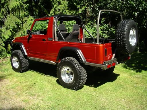

Here is my LWB I just finished restoring the body on.  As already stated it is very hard to find a clean one.  I replaced most of the tub sheetmetal with new factory panels that were brought in from Japan.  You are likely better off just stretching a short one by adding in metal in front of the rear tires.  The factory LWBs have quite a bit of rear overhang.   I have seen some nice stretched ones by OKIE ZUK over on Pirate.

Man - that is nice !!!
Thanks,
