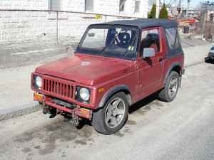

Hello all. I just bought a 1984 Sj410 with a 90 suzuki motor / drivetrain swap. I had a few questions concerning parts availability. What samurai parts will fit it? I could not find a brake master cylinder listed anywhere, and it is apparently bad. Could I buy a 1986 samurai master cylinder, which is boosted, whereas the 1984 is not? What about wheel cylinders, shocks and other assorted wear parts? These don't seem to be sold anywhere. Thanks in advance, as any help would be appreciated. Here's a pic of it from the craigslist ad. The idiot dropped the front 2" with blocks. That will be the first thing I undo.
