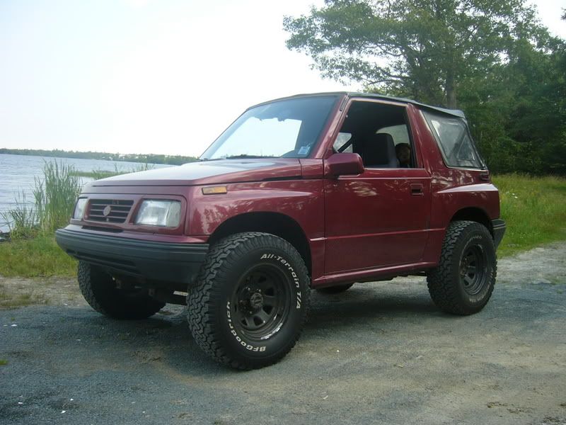

You can fit a 31" tire on 7" wide(not 8") wheels with a 2" - 2.5" suspension lift and some inner fender trimming. Street driving only - no heavy wheeling.

i had 31's on mine with nly some small coil spacers and samurai wheels.
then added some body lift and put 33's on it.
