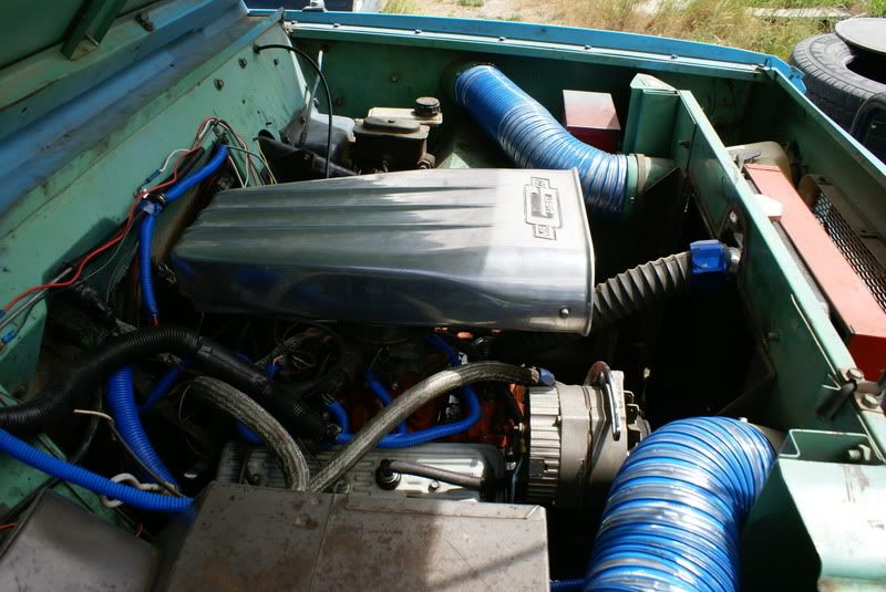

 Myself , I love the 4.3 . Now I have never put one in a Suzuki  but I don’t think it would be that hard .
I did do the 4.3 swap in my 1970 IH scout 800  , swap wasn’t hard  even though folks told me it would be and if you get an older  non vortec you can run a carb or TBI .
 I started  our with a 4 barrel on mine and then built my own TBI harness  . Like you  the thought of electronics’ simply scared the He77 out of me . But it wasn’t that hard and now that I have it installed  I  believe its much , Much better  then going carburetion.
 I wouldn’t expect the swap to a 4.3   to run anymore then  the scout did .
 Basically excluding the engine  she ran me around 500. that’s for new cross over  with  perches for the engine mounts . New input shaft  and bell housing  ,+ an electric fan   for cooling .
 Mine  with the headers , milled heads and readline cam ,  forged pistons .  was dinoed at just over  300 HP. With the stock IH 4 speed , she  will flat  make the front end light  in my little 800  when I need to .

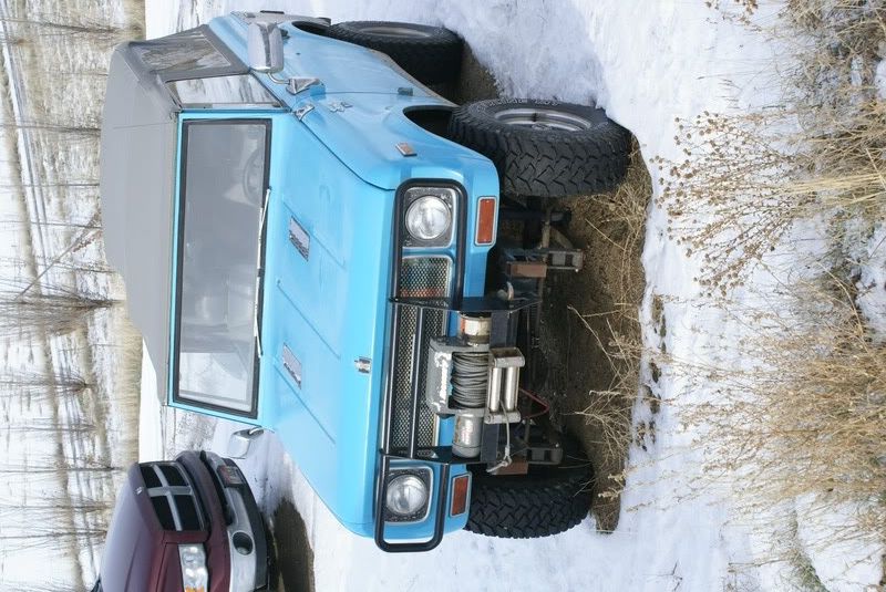

 Here is a shot of it in my scout .
 Put it in a Sidekick  or sami and  I think  she could flat get away from you in a hurry  even if left stock .

thanks for the input jeramiah, ive been thinkin that one over, the buicks are getting harder to find and theres no doubt the 4.3 is a better engine what with the 3.8s oiling issues, and yea even a stock one should be friggin nasty in a 1900 pound sammi
also a huge fan of the scouts, my first wheelin was in a 800 at 13 in south dakota chasing up cows, thanks for the pics , shes a sexy lady
