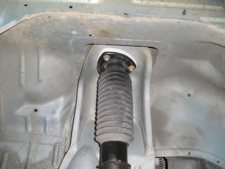

adding a spacer to a flipped strut mount can work out ok.
this is with 1/2" spacer, flipped mount(and longer bolts) and stock struts.
i'll bet jeff's strut spacers are real nice- he wasn't making them back then.
 think about a front end alignment and camber bolts.

I use 2.5" 3-bolt exhaust flanges for the strut mount, stack two and you get 1.75". I got mine for about $5 /pc.
Re: coil spacer install questions
« Reply #19 on: July 16, 2009, 05:06:47 PM »
I've been meaning to ask about that.  What are year Chevy are those off of?

« Reply #20 on: July 16, 2009, 06:08:14 PM »
WOW
those look like the real deal.
is that just a universal flange or from a specific vehicle?
Let's see some other angles.

« Reply #24 on: July 28, 2009, 06:53:39 PM »
WOW
Sorry, those pics are from a couple years ago. They're available at most muffler shops, basic 3-bolt 2.5" exhaust flange. exhaust pipe is measured ID, so the the hole is a bit bigger than 2.5" which is needed for the top washer. They fit perfectly inside the rolled edge of the strut plate.
