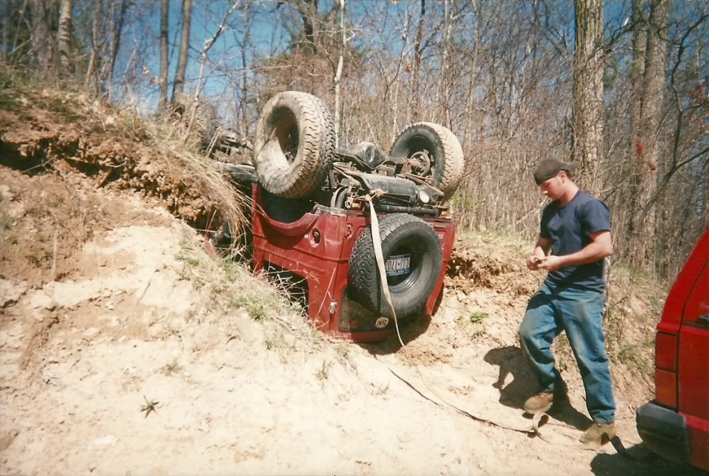

I had a 33x12.5 BFG on my old tintop. Worked great.
If they worked so great, why is the truck upside down???
Sorry...   ...couldn't resist...
