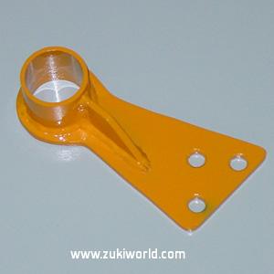

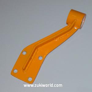

« Reply #13 on: May 14, 2010, 09:08:39 AM »
Here are c couple of pics of drop brackets I found on line... This is basically how I remember the pro comp brackest looking. ( a lot like the Calmini) notice that the brackets do not have the bend that rotates the diff around like yours.. Still looking for pro comp pics....
I remembered the procomp lift having streight drop brackets and the rotation of the diff being done with bolt hole placement and the cross member mount bushing...
Still searchin.
Re: 96 Tracker center link / alignement struggle
« Reply #14 on: May 14, 2010, 12:27:29 PM »
I think we have identified the problem, he should ship that kit down to me immediately to put on my rig.  :D
Could he be running the diff drop from the Calmini kit?  I know it runs at an angle in order to clear the rear cross member.
