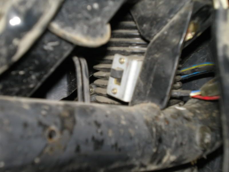

I figured it out, apparently the little switch under the dash does have a purpose. It's a reset switch for the check engine light, which is what the 'sensor' light is. I flipped it the other way and poof! no more flashing light.

From what i have read the light comes on every certain amount of miles for service reminder, and that switch is to reset it/turn it off.
When i got my sami, i pulled the gauges out and found that the owner before me didn't know about that little switch...so they just put some black tape over the light.

were is the switch yall are talking about?
Offline RHodge
  • 523
Re: '87 Samurai trouble/warning lights
« Reply #10 on: June 13, 2008, 10:32:05 AM »
mine was under the steering column,  just a little black switch
« Reply #11 on: June 13, 2008, 12:41:11 PM »
thanks. i found it
