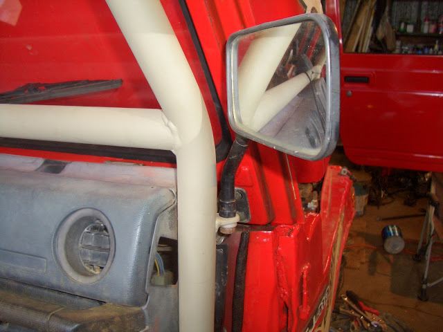

Re: how to make doorless samurai ???
« Reply #8 on: September 07, 2009, 11:58:51 PM »
After destroying my stock mirrors on random trees that jumped out at me I switched over to motorcycle mirrors.  Then just made a bracket that went on the doors and one on my roll cage.  Works great, keeps the mirrors in the stock location and all I need is a 14mm wrench to swap them out.
After the TTCW I am going to go back and re-paint the brackets black so they match the rock sliders and stand out a bit more against the red.
