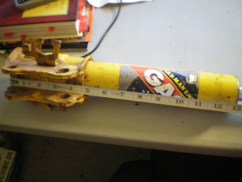

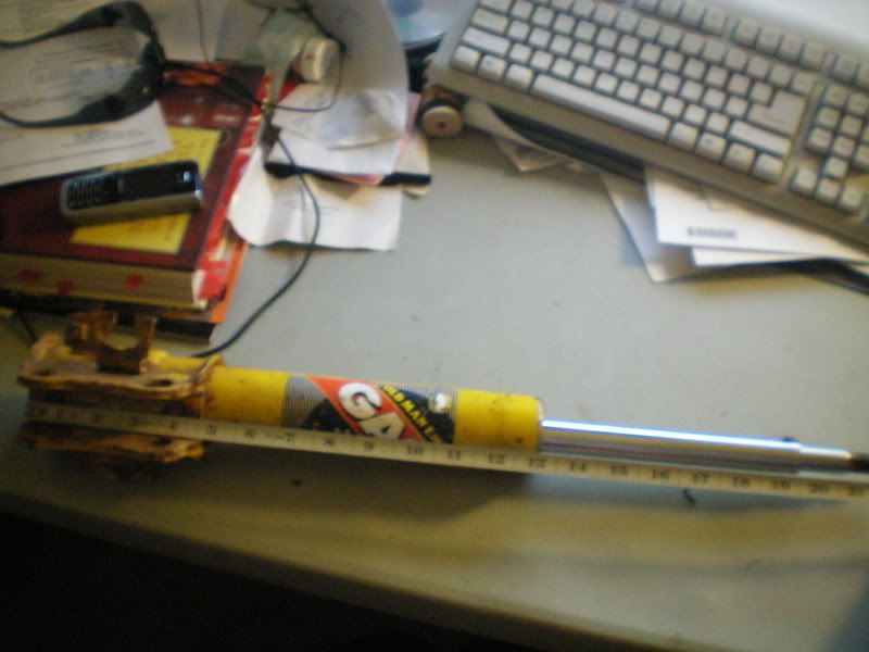

With a 3" drop, I believe you need to run a shorter spacer. 3" spacer will for-sure be too much, and I don't know if there's enough additional travel in the OME to go 3" all the way back up to the stock location. I would suspect a 1.5" spacer would be ideal. I know people have run hybrid Calmini & OME kits before, so hopefully someone with practical (instead of theoretical) experience will chime in.
Here's some measurements in case they help you...
