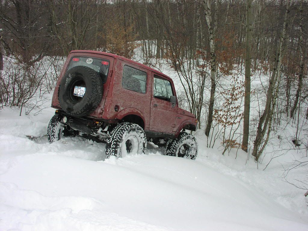

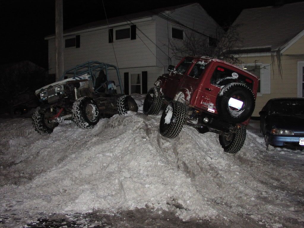

Oh I will I promise!   I'm posting more pics tomorrow.
http://www.cardomain.com/ride/2972943/1

Hey, look's like you don't have to worry about denting it. :laugh:
And as it has a SJ410 grill it is even neater.

« Reply #6 on: December 30, 2007, 10:28:18 PM »
oh no.... he laid it over on it's side a while back...  THATS what I we wanted it!  So we could beat it up and not care!   I'll cage it before long...

When you say tubing the back, do you mean a cage or are you cutting the back off?  Kind of sad to see that happen to a tin top...  :(

It's already beat up...    I plan to build an internal roll cage.   The tin top should stay on there for a while longer...  I'll post a picture of my rear tomorrow.  It's too dark and I'm too intoxicated right now!
