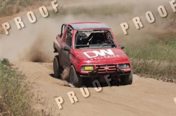

X2 on the Bilsteins. They would be kick ass on a trail rig. They were killer on my race kick for about 7 laps. Don't let that fool ya though, we beat the piss out of them and they still came back after they cooled down. Are you listening Bilstein? We need a longer, remote reservoir strut! Here is a pic of the Bilstein nest to the stocker
And a crappy shot of the abuse they got.

You guys DO pound those suspension parts! The Bilstein sure looks stout, that nshaft has to be twice the diameter of my OME struts, body looks a bit shorter though. Is that correct.
