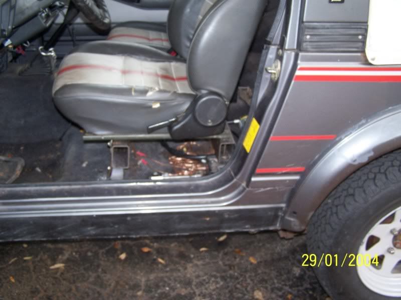

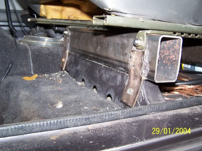

Well, I visited the steel shop today and  have an idea in mind,  I'll be documenting it if I remember to so others can use the idea later. some 2x2x1/8" square tube and a little 1.5x1/4" steel stock for mounting tabs, plus some welding, and I"ll have 2" of elevation.
visibility is the whole idea, when you've got long legs and a SHORT torso, like 12 year old boys are taller, its kinda helpful to do everything you can.

I got bored a few nights ago, and did a (very) crude mockup with some 3.5x3.5" landscape timber pieces to elevate the seat,and I'm settling on raising it 3" for my needs.
The tricky part I think is going to be the front mounts, since I've got to create some sort of way to keep the mounts in the right spots.
Bobthebiker
I made the risers today.  cost me JUST under 18 for materials,  and probably lunch for my buddy tomorrow for doing the welding work.
By raising the seat using a 2x3" tube basically, I also gained a spot for my breaker bar up in the front tube so its out of my way, but handy if I need it.   The change enhanced my driving confidence/comfort by about 500%, and simply put, I can see everything I was hoping to see around me.  best $20 mod ever.
