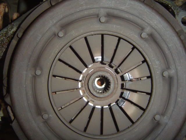

hey guys, dropped the Gbox, and had a look at my clutch. i think its farked.
does anyone know how and why this happens? about 5 or so of the ends have snapped off.
thanks
thanks
Wow, that's kinda nasty looking.
What does the throwout bearing side look like?  Is there anything damaged or sloppy-fitting there?
It may be that when you remove the clutch from the flywheel, you'll find several springs loose.
More pics!
Ack
