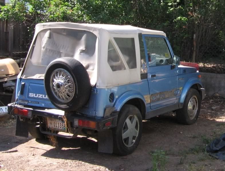

I thought I’d post this pic just to see if it’s the worst rotor anyone has ever seen…
This Sammi has been sitting in my folk’s back yard for a couple of years, it used to be my Gramp’s hunting rig. My half-wit brother drove it for a while then parked it in the back yard, he’s responsible for the condition it was in when I took over. The truck has 154000 miles on it but about 30000 of those were towed behind Gramp’s motorhome. Gramps has a thing about putting mud flaps and bug deflectors and other superfluous geegaws on his cars, as it sat it had hubcaps on the stock wheels and like a fool I didn’t take them off and look at the brakes before I drove it.
I gave gramps $50 for the title, charged the battery and hosed down the carb with some cleaner, aired up the tires then dumped a couple of gallons of regular in the tank and it fired right up. I drove it out of the back yard then around the block and it seemed ok enough to drive carefully to my place, so off I went on the 18 mile trip.
On the way home I noticed that the brakes were pulling a little to the right so I put her up on jackstands, pulled the front wheels and this is what I found on the right side. I can’t believe it didn’t come apart on me! The edges are literally knife thin.
No local auto parts stores had rotors in stock but luckily I found some in great condition for $15 each at a junkyard.

Those are pretty bad. But at 154,000 miles-30,000, it is just getting broken in, as these things will last forever. BTW, what year is it?

She’s an 88 with a bent tailgate… this is how she sat for the last two years.
She had a new timing belt and clutch about 4000 miles ago, the motor runs pretty darn good with no visible smoke.
So far I’ve changed the oil, using Castrol 75000+ 10w 40, replaced the front wheel bearings and the pads/rotors, and did the cold/hot idle speed adjustment.  Now the clutch cable is starting to go so I’ll have to order one of those.
The only other problem I’m having is no instrument/horn/dome power but the fuse is OK. Gunna have to track that down next weekend.
Not sure what I’m going to do about the tailgate yet, I was thinking about removing it along with the damaged bumper and mounting some kind of locking box in the bed.
