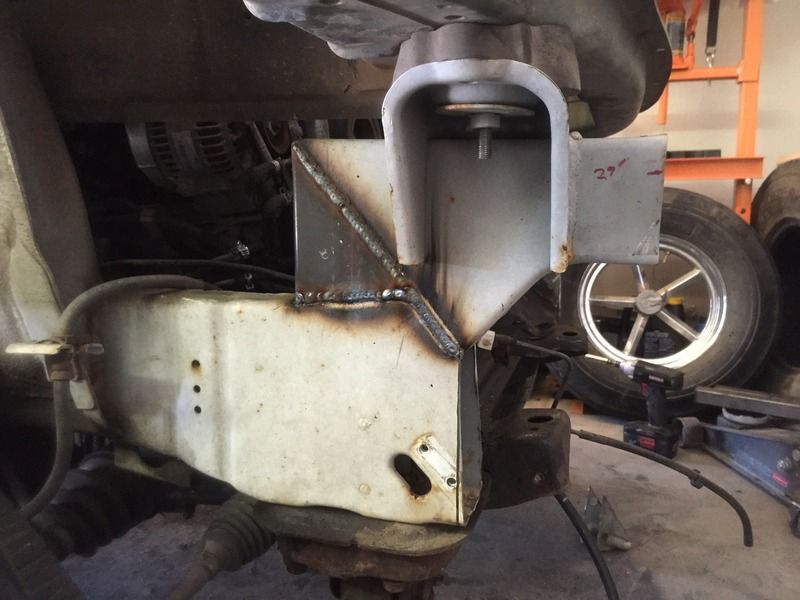

I stumbled across this build thread on the Zuwharrie IFS forum: http://www.zukikrawlers.com/showthread.php?t=54699 This guy did a 4" drop and 4.5" stretch to the frame and didn't do anything else to the front end other than raising the motor mounts and front body mounts. I think if I was going that route I wouldn't stretch it as much, and I'd probably only drop it about 2" and then do a 2.5" suspension lift to get the front crossmember a little higher off the ground. For the rear I think he put TJ coils on and lengthened the control arms. It almost looks easy:

if you read the whole thread there is a lot more to do than just chop and motor mounts  (brake lines, steering, frt ds , rad supports..etc.) it looks easy but if you are not fabricator and can not weld I wouldn't attempt. yes its a very cool concept but cutting my DD in half is not in the cards on my behalf. my 2c

Looking at those photo's, I would at the least fish plate that welded area with some plug welds for good measure.
The real advantage to a frame chop & drop is no changes to the suspension.  You have the lift you need and the suspension remains unchanged.  The wheels are moved forward for better approach angles and you have more room for larger tires.
When you do a suspension lift you limit down travel.  Even with a diff drop and longer struts, down travel is limited, because the CV joints can only take so much angle.  This would keep you struts running in the center with up and down travel.
