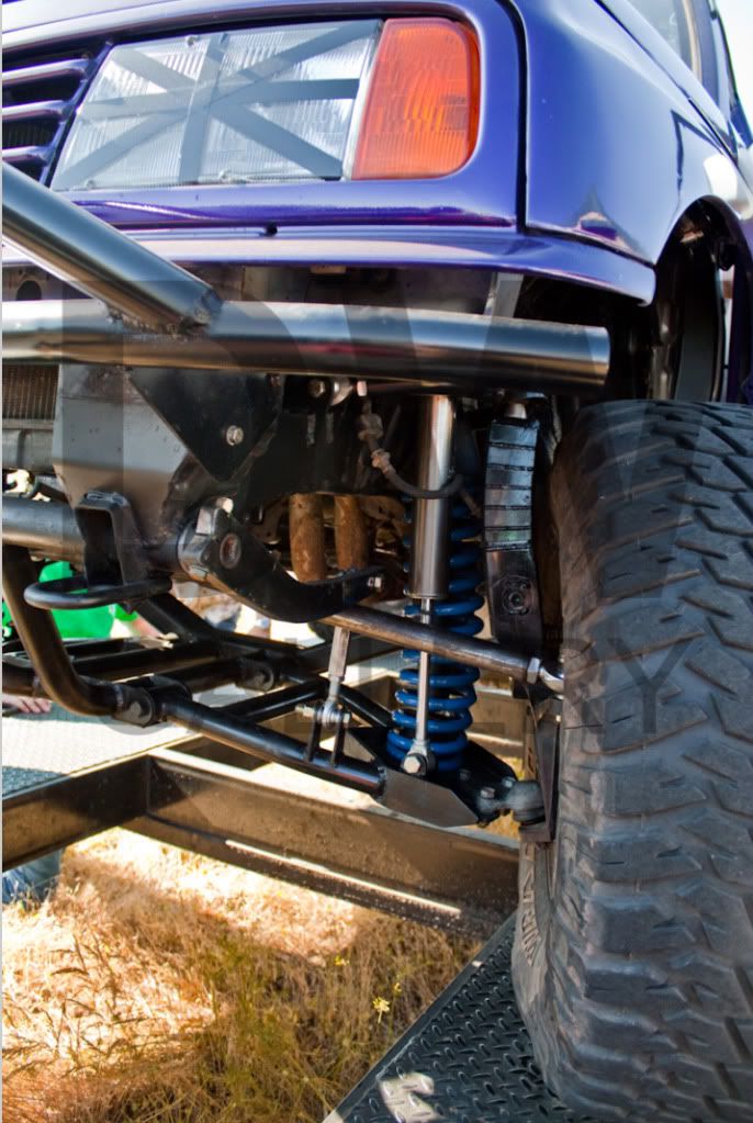

I've been toying with this for awhile. I want a set-up that requires minor fabbin' for the amatuers. Maybe made out of junk yard or off the shelf stuff. I keep getting hung up on HD CV axles with good range of travel. The slip joint ones like in the pic above cost (get ready....) about $650!! EACH!! I would sure like to know of any HD slip yoke, splined CV axles that were produced for any vehicle I could find in a U.S. junk yard.

I think this is a pretty slick set up.
Yes it's 2wd, but I think it could be adapted pretty easy.
do you have more info on this?

nice use of the front crossmember for the swaybar.........
It was the Liberty Overlands setup from the Zukiworld Challenge.  I believe there was some binding issues with the shocks, but you would have to ask Eric.  Sadly a computer took him out of the competition early.
I cant believe he brought an 8 valve and didnt bring a spare computer!
