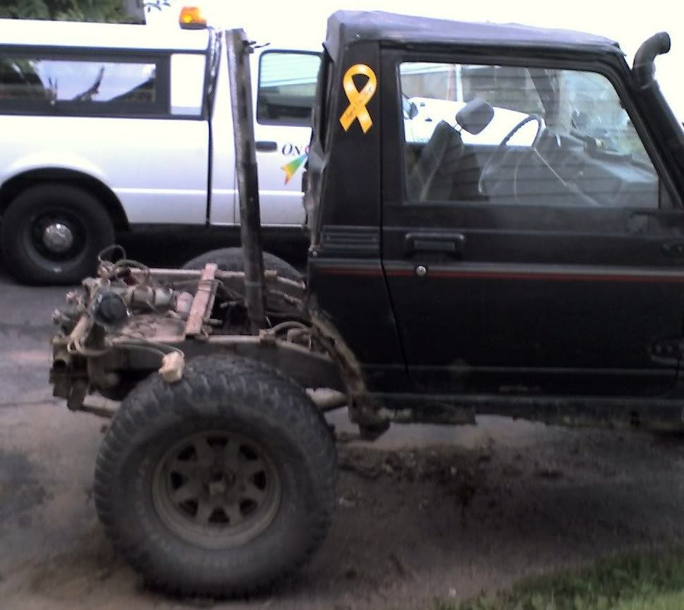

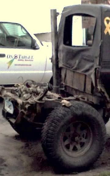

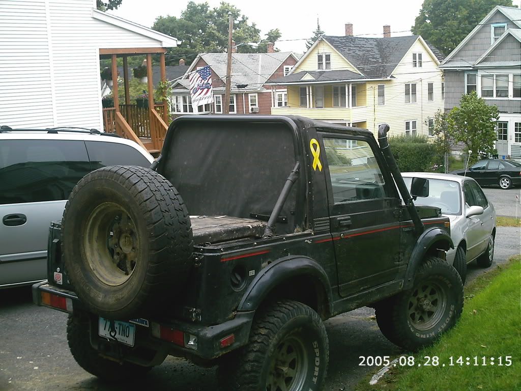

Offline phoenix827
  • 44
Re: Wanted Pics of 31" or bigger tires on 15x5.5 rims
« Reply #17 on: January 26, 2010, 02:58:45 PM »
No pics on this (newish) computer, but I am on 32x11.50's on stock Zuk rims, NON flipped! Tires hit the springs |removethispart|@ full lock, and I had to cut the bumpstops off the rear frame before they took out my sidewalls, but thats it. Remind me and I will try to get the pics moved.

Found a couple pics online,,,,
as I said, 32x11.5's on stock 15x5.5 rims, NOT flipped. Sky stage 2 SPOA, only other mods to clear the tires was the bumper ends. IIRC That IS as far as the tires turn, they should be clipping the springs in that pic. Not enough to really notice driving tho.
And a few more that are a bit more up to date,,, sorry, phone pics,
