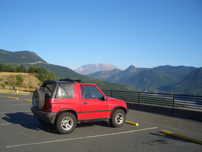

Spacer lift is nice and easy.  I run GV springs in the front and 1" spring spacer in the rear and some Toyo 235/75R15 tires and some 1" wheel spacers.  I do need a Strut spacer though, as I have almost no down travel.
I used to run a 3/4" spacer up front but I found the ride to be a little stiffer then I liked, so I swapped to springs.  It's a lot softer ride then running with spacers, which is what I wanted in a DD.  With a sway bar in the rear it handles great.
Serious? You find the GV springs to be softer than the stock spring w/ spacers??
Dave
I found them quite a bit softer in the front, especially over poorly maintained freeways and Seattle side roads.  Same as BRD HNTR, who is running a set of cut down OME XL7 lift springs.
The rear was a bit to stiff as well, but I am also running an anti-sway bar to help keep down body roll.  I switched to some Bilsteins in the rear and that softened up the ride quite a bit.  I'm waiting until the engine swap to put the new Bilstein struts up front, I expect that will smooth the ride up even further.
Having done both I would go straight for springs if I had the money.  Otherwise spacers do the job just fine.  That is why we both still run them in the rear.  :D
