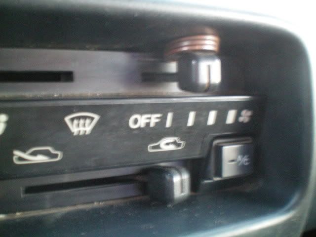

The switch was poorly made, and slowly bends away from the contacts (the retaining mechanism that keeps the switch at a particular speed also bends the switch up (away from contacts) each time you move it. Eventually this moves the contact points away from one another. I bet if you push down on the switch in the other speeds, it'll activate the fan.
My $0.03 fix was to put 3 pennies between the top of the switch, and the console molding. It's very easy to move the switch & pennies when going through the speeds. They've only come out when I've beat the hell out of the kick on fire roads.

Sounds like you have a different problem than me. In case anyone does have the same problem I do, here's what the $0.03 fix looks like:
Okay, it's more of a band-aid than a fix. But, what do you want for $0.03  ::)
