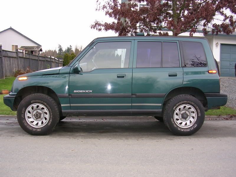

I have 235/75R15's and this is what it looks like...I think next year I will probably save up for the Calmini 3" lift so I can run 31" tires.
At first I was thinking of going for a body lift to fit 31" tires but that would be pointless because then you would only gain 1" clearance from the tires. Therefore I have decided if I am going to get bigger tires, I am almost certainly buying a suspension lift.
If I were you, I wouldn't get 235's and a 5" lift. It will look pretty rediculous and you could fit alot bigger of a tire in there with that much lift.
