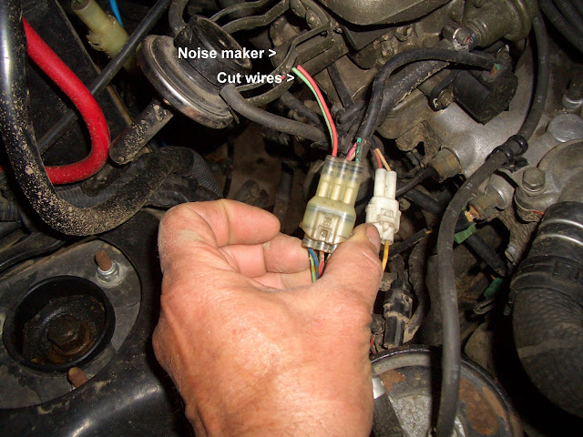

Re: Fast idle at startup and engine noise issues
« Reply #5 on: May 26, 2009, 05:55:28 PM »
Sounds like what happened to my 1.6 8v Tracker.  There was a real audible clicking noise when I turned on the fan.  The offending solenoid is on the right side of TBI inlet (as you are looking from front of car).  I unplugged the plug shown and noise stops, warm low idle also drops to about 300 rpm.  I cut the wires shown and noise went away, mileage dropped 1-2 mpg.  When checking out other issues I found that the air flow channels under the tbi were plugged.  I have cleaned the buildup and replaced the tbi base gasket, but the noise is still there.  Check your vacuum hose to distributor to see if it has any vacuum.
I have not pursued it further because with wires clipped it runs ok, and I have a BIGGER motor to replace it with in near future.

Thanks BRD HNTR that helps a lot.  I tried unplugging that smaller plug shown (before I got your picture just now) and with that smaller plug unplugged (the red, and yellow two-wire plug), the tracker wouldn't kick over.
I located what I think are the two idle adjustment screws on the backside of the throttle body.  I have included a picture, and this is what I think: someone let me know if I am incorrect here.  The three things with "???" are the things in question: by looking at it more extensively, that is my assumption:  will adjusting one of those two screws bring the cold idle down?  I realize it needs a higher idle when "cold", but my cold idle is WAY TOO HIGH at 3,000 RPM.  Just wanna bring it down a bit, not eliminate the cold idle altogether.
And BRD HNTR, I unplugged that larger plug, and the idle dropped a lot the next time I started it.  Is there anything wrong with doing this?  Could it cause any problems?
« Reply #7 on: May 26, 2009, 09:23:07 PM »
Try this for idle adjustment
http://www.kick-fix.com//IDLE-AIR/dutycycle/idle-setting.html
or this
http://bbs.zuwharrie.com/content/topic,31656.0.html
I think it has to do with the noisy air solenoid valve, as it was idling just fine before the noise began.  I tried lubing the noisy valve and did not change.  Also I have been running about for at least a month with the wires cut.  Other than the slight drop in mpg, I have not seen any problems.  But you know there is one.

BRD HNTR, I unplugged that connector earlier with no problem, with it dropping both the cold and warm idle.  But I tried unplugging it later tonight and it ran but then threw the check engine light on the instrument cluster.  So I plugged it back in and fooled with the screws a bit more...
Actually I took a wild guess and kept playing with those two screws I pointed out in the above picture.  I figured that the one on the bottom is the warm idle, the one at the top, the "kicker" that adjusts on that vacuum diaphragm, is the cold idle setting screw.  I toyed with it for about an hour, starting it up, letting it run for 5 secs, then shut down (to keep it as cool as possible...since I am trying to adjust the COLD idle).  Got too warm, so I started toying with it just now as I was pulling it into the driveway...my earlier settings from the afternoon were great, but it idles down too low and was choking itself and dieing at warm idle.  SO turned up the warm idle, down on the cold a bit more, and got it to start, it revs to about just below 2,000 RPM, then idles down to about 1,000 RPM, then once it is warm, the noise goes away and it holds a smooth idle at about 700-800 RPM.  SO I am leaving it for morning as it is 1-AM Fresno time, and I live in a city neighborhood...and I am confident it will work a lot better.  Before, it used to start and climb to 3,000 to 3,500 RPM immediately upon startup...so 2,000 might be a little high still but better than 3k+ rpm.  I'll post a reply after the "cold" morning startup.
« Reply #9 on: May 27, 2009, 05:15:07 AM »
So adjustment of idle screws got the solenoid to stop cycling?  Let me know if that works, I can solder my wires back together.  Did you use the instructions I linked?  Which one?
