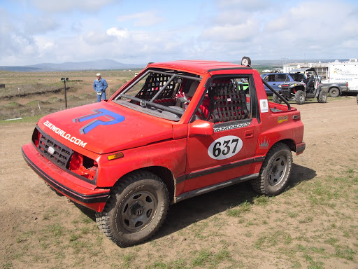

« Reply #5 on: October 30, 2010, 12:30:11 AM »
Here is a 91 with the front and rear bumper trimmed and 30x9.5" tires under it.  The only modification is 4 door spings.
While the rear is good to go the front does rub on the top of the body after heavy impacts.  We also had to adjust the steering stops out a bit so the tires don't rub on the frame.
