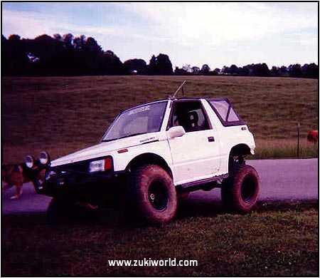

any body got any pics with flex ?

« Reply #3 on: November 13, 2011, 03:14:07 PM »
