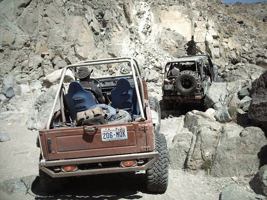

 I have two broken rear taillights and i don't want to spend $150 dollars on new lights is there a aftermarket street legal solution that will fit a c channel custom bumper that i am planning on making for the lights. i was thinking trailer lights but was told it wouldnt be street legal. thanks for any help.
i saw the rockyroad rear crawler bumper with oval lights but don't know where to get them.

You can use trailer lights.  I am using them currently and I know other people who do with no problems.
Yep, just go to your local auto parts store or trailer/truck shop.  I would probably stick with the 6 light setup in the rear:  Brake/running light, Turn Signal, Reverse.  If you want to switch to a two light setup like trailer have (Brake/Running/Turn Signal, Reverse) you will need to get a powered 4wire trailer plug box to put in, then wire that into your tail lights.  If it isn't a powered one (aka, the more expensive one) then your turn signals will act funky whenever you step on the brakes.  Not recommended unless this is a trail only rig.

Wal-mart even sells the oval lights and grommets now.  You will have to get 4 (2 for brake lights, 2 for turn signal lights), unless you get a trailer adapter (as mentioned earlier) and splice it inbetween your existing wiring and the new lights.
"Trailer" lights are perfectly legal to use on vehicles as long as they are DOT approved (which I think they all are.....otherwise they will say something like "for offroad use only").

You can use all red lights, but only if you stick with the two-light system.  If you have the third light it has to be amber.  In order to do the two light system you will need to pick up a 4 wire trailer lights adapter and hack it into the system.   Additionally, if you get the cheap one your rear turn signals will NOT work when your brakes are on.  Spend the extra money and get the powered box if it is going to be a regular sight on the roadways.
Or you can just get the additional two smaller turn signal lights as mentioned before.
