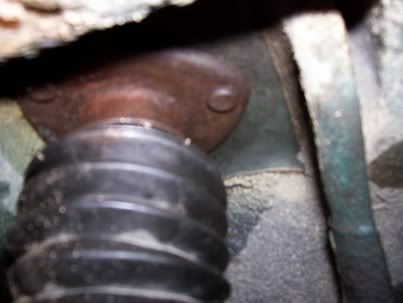

« Reply #8 on: April 08, 2006, 03:00:40 PM »
heres a couple of pics ..........finally !!!!
