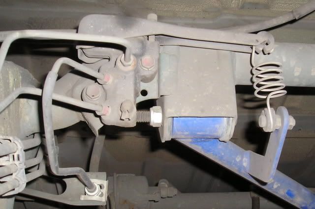

Re: Load sensing proportioning valve troubleshooting
« Reply #8 on: July 18, 2007, 06:05:22 PM »
Looks like there is also an Adjustment screw on top.
Here's anice close up pic of it.
and there looks like there is also a bleeder valve on that too.
SOrry so dirty. ;)
« Reply #10 on: July 18, 2007, 10:47:23 PM »
SOrry so dirty. ;)
BTW: this shot is off of my 97 4dr which is saddly sold to a guy that has already
lifted it with the TrailTough SAS kit and Yota axles.
Pics when ever I get a hold of them.
