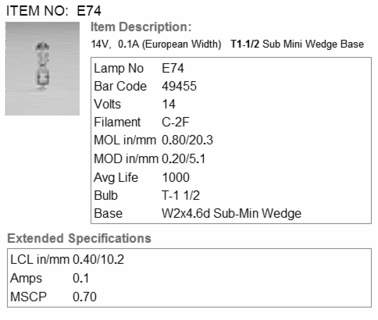

I found that the small bulbs in my Samurai were E74, a slightly smaller European size, and the holder would not accept the standard 74 size. The larger bulbs are a standard 194 size, and easily replaced with new.
I'm thinking of going to LEDs with the small lamps. I'll need some of each: 3-green, 5-red ,1-blue. You can buy them already mounted in the twist-lock holders at superbrightleds.com. But I'm NOT going to replace the battery lamp, as the higher current is needed to get the get the alternator started.  And it's almost never ON, so it can't burn out.
