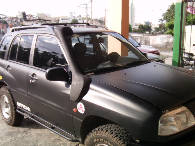

As a matter of fact I bought and installed this 2" kit from Low Range Offroad [LRO] (jeff's red kit I think) a few months back.
http://www.lowrangeoffroad.com/suzuki/tracker-vitara-gv-xl7/suspension/basic-and-complete-2-inch-spacer-budget-lift-kits.html
I am very satisfied with the results: ground clearance is great compared with before. I went with the Doetsch shocks because I read somewhere (can't remember where) that rear OME shocks were too short for the lift with LRO spacers. I also installed diff drop brackets and the panhard bracket. Handling is great; the tail used to bounce right when going over a speed bump; now it does not.
The rig looks like this now:
I am a forester, and I use my car for work. As we often have to climb as high as 10,000 feet and above, it can be VERY foggy , and the stock lights are not much good in this conditions. Do fog lights really make any difference??

The snorkel was manufactured by Tecnotrilha (http://www.tecnotrilha.com.br/index.asp?item=conteudo&codmenu=8336) in Brazil, but it is essentially he same as OGZ, though this latter company seems to make them better. Mine is fiiberglass. Since I have the snorkel I haven't really forded any streams (we're at a El NiƱo year and rainfalll has been low almost a year ) that I would not have dared without it, although the year before that I did some crossings that I was pretty uncomfortable with and only went through because going back was worse in terms of danger (narrow roads along a terrible drop, armed groups, etc.) or plainly just too far. Would purchase again the snorkel, but from OGZ (found out about them after buying mine from tecnotrilha).

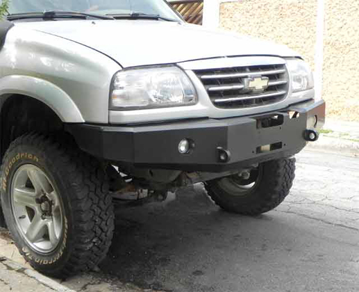

There's some nice looking stuff there, at attractive prices too ...
Fibreglass snorkel - USD$180
Winch bumper - USD$400
Unfortunately, even though geographically we're neighbors with Brazil, there is very little trade between our countries - it's actually easier for me to order stuff out of the US.

What website can i order the winch bumper from. Been looking for a decent bumper for a decent price, seems like there isnt many options

Did you read the thread or just look at the pictures?  There is a post in the thread that has not only the name of the company who makes that bumper, but also a link to their website ...
