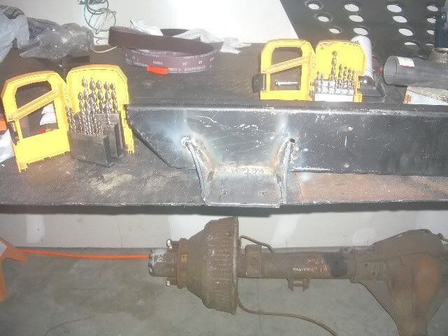

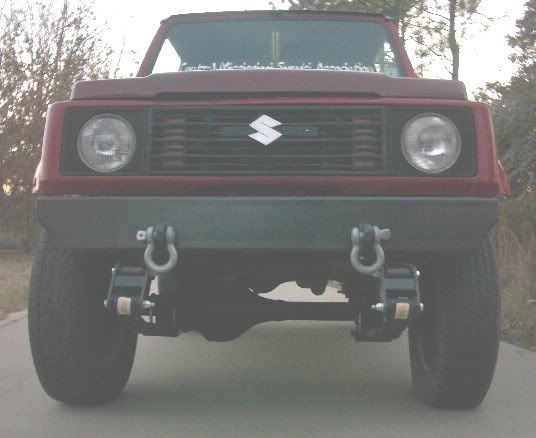

well, i got back late last night from the fab shop. i have it home, but it is still on the trailer. im tired and will work on it this weekend some... ;D
here are some pics i took last night of it coming together.
bumper fab
front shock mount fab
the first set he cut out was too short and was gonna give the shock a bad angle, and then a TERRIBLE angle once i can get some hoops, so we went back and made these.
and bump stop fab
still have to paint, and get the bumper wired for lights and mounted and then measure for shocks. i think the front bump stops are gonna be too low tho, so i may have to grind em off and shorten them... i will see once i get the tires mounted...

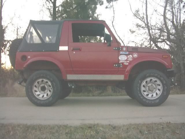

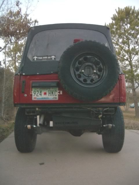

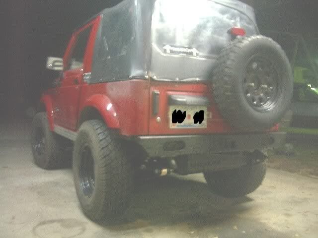

tonight i got the tires and wheels installed, the rear axle moved back an inch, the bump stop brackets painted and bump stops installed, and the shock mounts installed. also got the bumper bolted up and rear brake line installed. ;D
all thats left now is to trim the bump stops to desired height, cut out two more light holes in bumper, rear tow points, hitch pin holes, measure and install shocks, and bleed the brakes. once this is done, i will be able to tell if i will need driveshafts lengthened or just install some spacers. and i THINK that is it for now. ;D oh yeah, gotta install my spidertrax arms to the tcase and my belly skid. also will need some sort of diff armor, but i could possibly squeeze by without that right now...
i still have to get upper shock mounts, better shocks, and a stinger, but that comes after zuwharrie.
pics:
and i ordered some more low profile bump stops and slid them in tonight.
up front i have 1 1/2" uptravel and out back i have 1" up travel, so i am just gonna cut the bump stop part instead of pulling the brackets off since they are welded to the frame.
i think the stance of my truck is a good one. after zu, like i mentioned i will get upper front and rear shock mounts, and diff guards, rock sliders, and try to install the kick power steering off my parts truck. just dont have enough money right now. ;D
