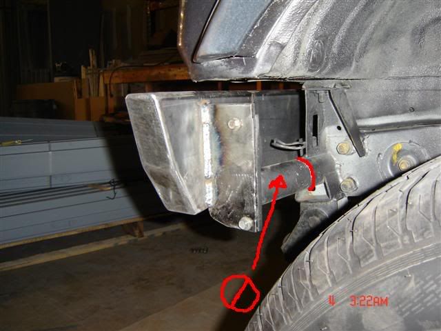

gotta say that's a good looking front bar, and no doubt it will look even better when finished and painted.
even thought i dont have much to do with sammys, i've picked up on a few things on the way, and one is that you will find that you will need to cut the bumper end supports off if you are going to run anything from a 31" tyre upwards.
i dont think i could explain it best with out a pic.
so you need to cut it at the red line-ish, and throw away the ends. hope i could help, and i look forward to seeing more of your projects as they come along.
cheers

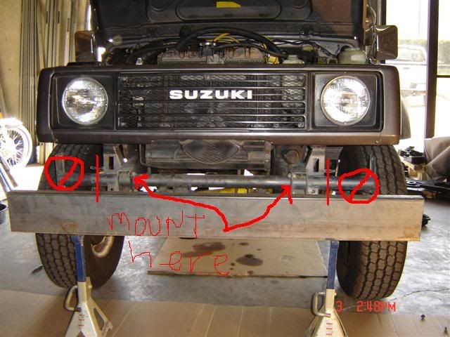

here is a better pic. and you could mount the front bar directly to the ends of the chassis rails.

Yep,Sikid is right, sad to see that much good work has to be re-done, but you'd better do it or you'll never run bigger tires then the ones you've got now. And don't start with: "Oh, but I'm pretty happy with the tiresize I've got"..................You said it yourself: It's your first Sammi ..................and you don't know what's coming next ;), empty your wallet for all the nice stuff ;D
We've all been there, thinking the rig would be finished after one mod......................and then you see something else that could be changed.........and again something else....................and then.............. 8)

Looks good but I agree with the others to cut the stock mount and relocate it to the two holes on the front of the chassis.
Even if your not worried about the tyre rub now, Chances are if (when :D) you whack some thing with the more solid bumper you have now the thin wall mounting tube will just push back against the tyres which would be a total PITA on the trail.

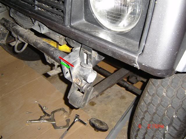

ok, i dont mean to pick on you, but i cant really see how you've mounted it to the chassis rails.
i see that you've made new mounts on the front bar, and braced/gussetted it a bit, but where it mounts to the frame, is it only on the inside 2 holes? if it is, i think you should make a crush tube for inside the frame (GREEN), and put a bolt all the way through the frame (RED).
i have seen the frame tear apart, and usually, its either the inside holes, or the outside holes.
but if you've done that, then it should be plenty strong enough to fit some rated eye bolts to the bar, and you can use those for recovery. looking good now.
maybe you can have a look around at a wrecking yard/pick-n-pull for some indicators off another make of car. just a suggestion.

and for the end of the round tube that you cut off, a lot of us have just left it open, as you can just get the hose in there and hose anything out the other side. if you cap the end off, you will never be able to see whats going on inside. i dont think it really matters though.

For the front crossmember: find a piece of tube that fits snugly into it, drill some 10 mm holes in the frontmember, hammer in the tube that you got and have that sticking out about 1 centimeter each side. Weld the tube at both ends and through the drilled holes. Voila: extra strength !
Sorry for the small pic, it's from my website, I can mail you the original bigger one, but I guess you get what I mean ;)
