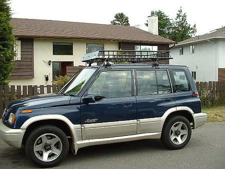

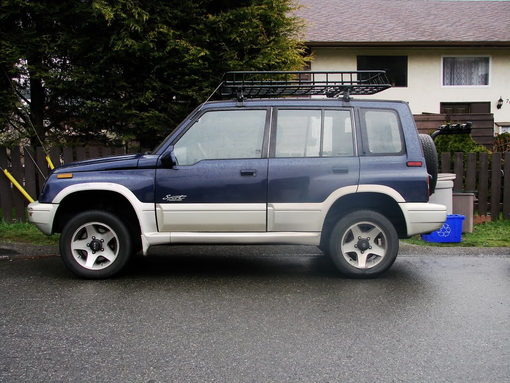

well, i have had some vitara springs laying around and also got some of Jeffs spacers. the rear vitara springs didn't fit that well so the rear is stock springs with spacer adn the front is vitara spring with spacer.  the front is just under .5" higher. i will level it out int he back. need to do a strut mount flip and new shockes for hte rear as well. also have some 30x9.5's availible to me. there a MT on 15" steel wheels. need to see if the 15's will fit on the sport.
anyways, here's the before and after pics. so far the only cost was the spacers.

after
